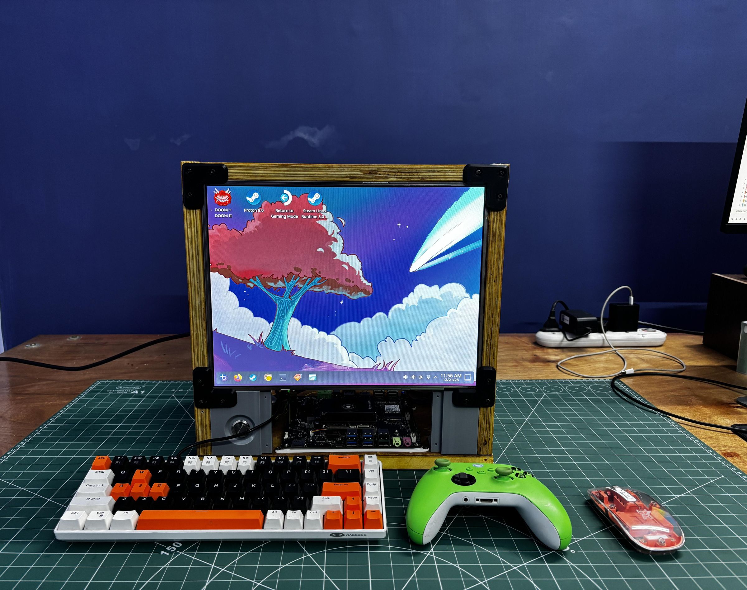

Greetings everyone and welcome back. here’s something I’ve been really excited to share.
I’ve been working on a simple but powerful setup that connects an Xbox controller to an ESP32-C6 DevKit over BLE and displays all the input data live on an ILI9341 SPI screen. It started as a way to visualize controller input—buttons, triggers, and analog sticks—in real time. But once I saw how responsive it was, I realized this could be much more than just a visualizer.
The real reason behind this build is a project I’ve been developing: a clock-based Snake Game Console. It looks like a regular clock, but when you press a hidden button, it transforms into a playable Snake game powered by the ESP32-C6 and controlled wirelessly via an Xbox controller. Instead of cramming all the technical details into the main article, I created this separate walkthrough to cover the full build process, from BLE pairing to display logic and game control.
The ESP32-C6 handles BLE input and display rendering smoothly, and the whole thing runs without lag or flicker. It’s clean, compact, and ready to be extended into robotics, gesture control, or any interactive project you can imagine.
This Instructables walks you through the entire build process from start to finish and takes a deep dive into the code that powers it all.
So let’s jump right in and get this project started.
