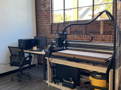

How to safely use the Carve CNC machine to make a cut and pocket engrave.
CNC Machine

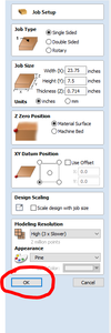

Step 2: Job Setup
Complete the Job Setup information with the width, height and thickness of your material or working area of the material you wish to cut. For basic use, ensure the rest of your settings here look identical to the screenshot shown. Keep in mind that this sets the job as single sided, Z Zero Position to Material Surface, and XY Datum(Origin) to bottom left. For the CNC machine we are going to use, it is required to use Inches as our unit and Z Zero Position as Material Surface, as this allows us to use their system at the best quality.
Step 3: Next
Press OK

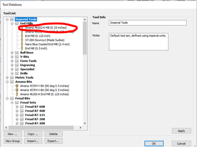

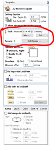

Step 10: Toolpath Window
In the Toolpath window, press ‘Select’ in the Tool section of the options.
Step 11: Select in Window

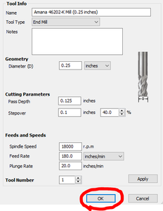

You will find the Amana 46202-K mill listed there, go ahead and select it.
Step 12: Change Settings
Make sure the settings look like this for cutting wood and press ‘Okay’.

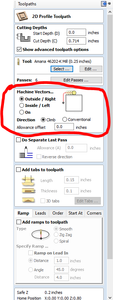

Step 13: Settings
The next section of options will determine whether the Profile cut will be run ‘Outside’, ‘On’, or ‘Inside’ the vector line. For our project we will select ‘Outside’ so that the cut-out will be the exact dimension of the circle we had drawn or imported.
(Tip: ‘On’ the line option is useful for shallow profile cuts that are meant to essentially engrave a path or letterings of some sort, and the ‘Inside’ option is useful for interior cut-outs on a job.

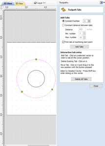

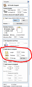

Step 14: Add Tabs
We will now add tabs to our toolpath in this next section. The ‘length’ and ‘thickness’ options here will determine the size of these tabs. If unsure, copying these values is just fine. Check the box to Add Tabs and then press Edit Tabs.
Step 15: Place Tabs
All we have to do with the Toolpath tabs is simply click on your vector line where you would like to add the tabs. For this 3” circle cut-out we will add three tabs at these locations. You will see a yellow box with a ‘T’ in it where the tabs are being added. Press ‘Close’ when you are finished adding the tabs.
(Tip: Try and add tabs on your vectors where they will be easily sanded or routed off after the job is complete. Make sure you are confident in the amount of tabs you add to keep the part in place as the job is running)

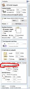

Step 16: Add Ramps
In the next section we will check the box to Add Ramps to Toolpath. This will make the cutting bit approach the material at an angle as it goes to the pass-depth.
(Tip: The settings here are fine for a 3” circle, but for something smaller, you can decrease the ‘Distance’ option if you feel it is necessary.)

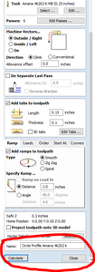

Step 17: Name Toolpath
Now all we need to do for this Toolpath is to give it a name and press Calculate.
(Tip: It is recommended to name the toolpath something unique with the Tool name and number in it so that it can act as an identifier and reminder through-out the process of running the job)

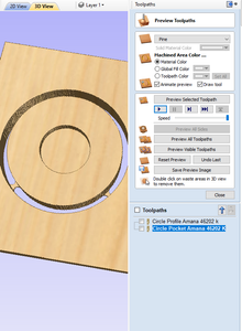

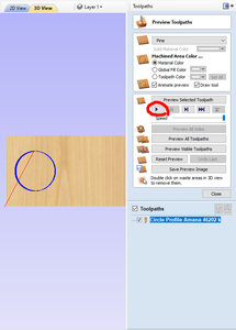

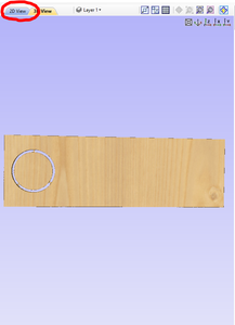

Step 18: Preview Toolpath
You will now be able to Preview the toolpath by pressing the Play button. You can click and drag to rotate the 3D preview and inspect the part produced by the toolpath. You should see the tabs you added and observe any issues with your Profile toolpath settings here and go back and modify them if needed.
(Tip: You can set the speed of this preview if desired to see the toolpath at a s,lower pace.)
Step 19: 2D
Press on the tab here labeled ‘2D’ to go back to the view where we can select our next vector for the next toolpath we will create.

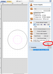

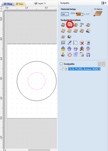

Step 20: Pocket Toolpath
We have selected the inner circle vector for our Pocket toolpath we will be creating. But we will also need to press on ‘Close’ on the toolpath preview window to continue.
Step 21: Select Pocket Toolpath
With the inner circle vector selected, we will now press on the Pocket toolpath icon to continue on and change settings for that cut.

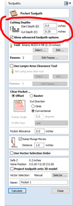

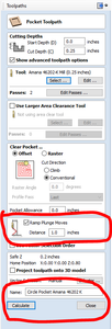

Step 22: Depth
We will first set the Cutting Depths for our pocket toolpath. For our example material we will be cutting at a 0.25” Cut Depth with a Start Depth of 0.0”

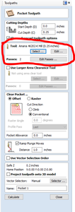

Step 23: Double Check
Since we are using the same cutting bit for this toolpath we just need to ensure it is showing up correctly here, and if needed we can press Select and make sure the settings are the same as shown in the picture for the Profile cut bit settings.

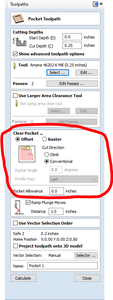

Step 24: Offset
We can choose here between an ‘Offset’ or a ‘Raster’ cut for our pocket. If unsure on the differences between these, just go with the default ‘Offset’ setting as we are going to do here.
Step 25: Ramp Settings
For a smooth plunge, ensure the Ramp Plunge moves is selected, and based off of our circle Pocket dimension a 1” distance setting works just fine. Then simply name your Toolpath as we did in the Profile toolpath with a different identifier but with the same tool name and number then press Calculate.

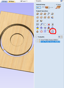

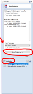

Step 27: Save Toolpath
Next, close your Preview window and press the Save Toolpath icon so that we can get these toolpaths written to a file to be run on the CNC.
Step 28: Chance Order
You will see your toolpaths near the bottom of this panel. Make sure you press this Up arrow if your Pocket toolpath is underneath your Profile toolpath as this one was. We want the pocket cuts to run first to reduce the chance of the part coming loose from its tabs if run after the Profile cut.

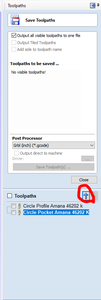

Step 29: Check Settings
Ensure that the Post Processor is set to ‘Grbl (*inch)’ and check the ‘Toolpaths’ box before pressing Save Toolpath. We will be running the Profile and Pocket in the same job, so we will have both boxes checked and be saving them into a single file.
(Tip: If your job uses multiple cutting bits in the toolpaths, it is important to not save them together and only check the boxes one at a time to save them separately so that they can be run one after another allowing you to change bits between cuts.)
Step 30: POWER ON
Turn on the X-Carve Pro CNC

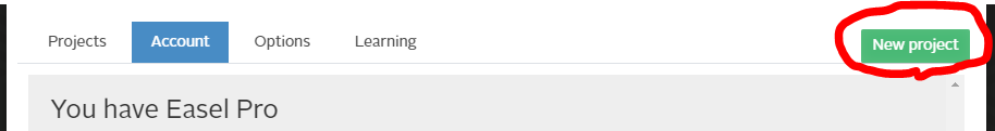

Step 32: New Project
Select ‘New Project’

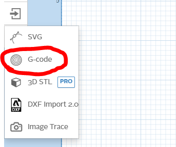

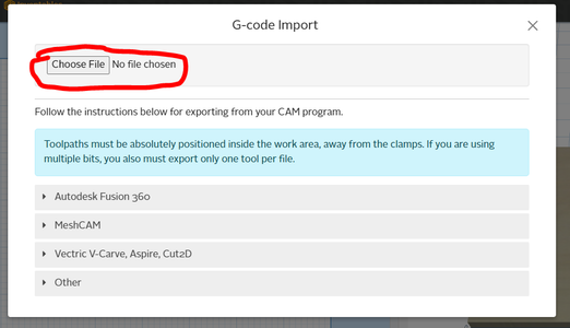

Step 33: Import Gcode
Use the Import button to import our toolpaths as G-Code
Step 34: Choose File
Select ‘Choose File’ and locate your saved toolpath which will be a ‘fileName.gcode’ file. This is our toolpath we saved from VCarve.
