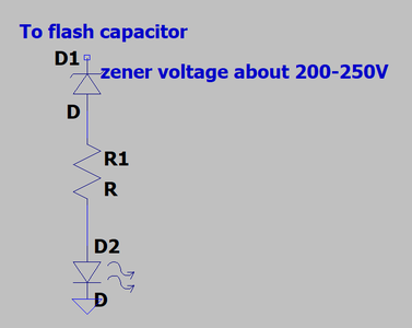

The flash succesfuly fires above 220-230V so adding zener (or series of zener diodes with overall zener voltage of about 250V), resistor and led to indicate when flash is ready can be beneficial and eliminates the risk of overcharging flash capacitor.
