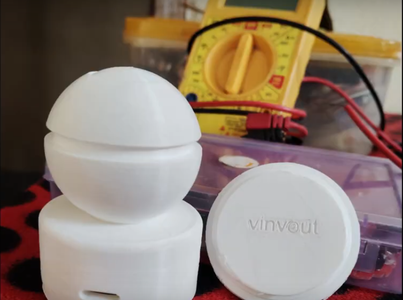

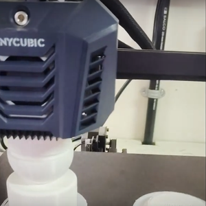

I’ve always loved creating projects, but I noticed that many of my earlier designs lacked a polished finish. Determined to improve, I started learning more about design and fabrication, culminating in this mini desktop lamp. It’s my first 3D-printed design, and though not perfect, it’s a significant step forward.
Initially, I planned to use an ATtiny85 microcontroller for this lamp, but then I remembered my ESP32-S3 sitting idle. Its advanced features made it the perfect candidate for stepping up the project.

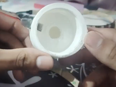

Step 2: Challenges in the Design Process

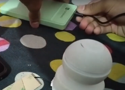

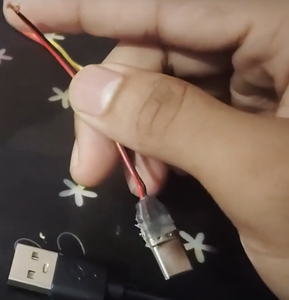

Being my first foray into 3D design, there were some inevitable hiccups. The most notable issue? The hole for the USB port wasn’t aligned properly. My solution? A bit of ingenuity and some brute force. I trimmed the coating and made the USB port fit snugly. I also adjusted the wire lengths for a more seamless assembly.

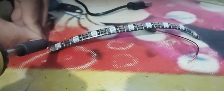

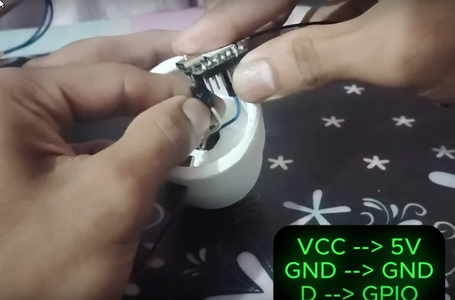

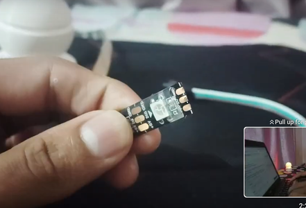

The next step was adding the LED strip. I used nine LEDs for the lamp, soldering the VCC, ground, and data pins together. The connection to the ESP32-S3 was straightforward:
  1. 5V to power the LED
  2. Ground to the common ground
  3. Data pin connected to any GPIO pin on the ESP32-S3
To control the LEDs, I installed the WLED firmware on the ESP32-S3.

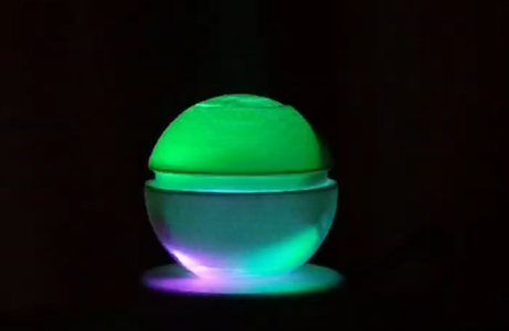

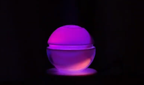

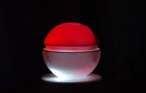

For power, you can use a 5V adapter or even a power bank. Once powered, the lamp can be controlled via your phone or another device. WLED’s functionality makes it easy to customize the lighting effects, and the results are stunning—even more so in person than on camera.
Step 5: Endless Effects and Vibrance
One of the highlights of this lamp is its plethora of effects. The sphere design enhances the visuals, making some effects look absolutely mesmerizing. Whether you’re working late or just want to add ambiance to your space, this lamp is a perfect companion.
