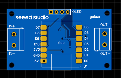

Step 4: Pcb
This PCB is designed in easyEDA, I designed this PCB to be as small as possible thanks to the small size of Xiao

for this project, I sourced all the parts for the INA219 current sensor module, I desolder all the components from that module. and solder all the components to the new PCB, in the end, solder both the OLED and wire connector
