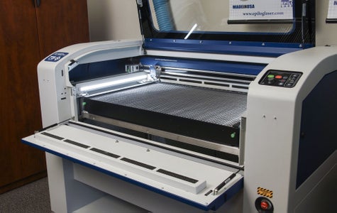

  • Laser cutting machine

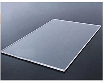

For foot pegs either stick ready made plastic pegs or cut rectangular slab piece from acrylic sheet using laser cut machine, stick with any super glue you wish. Use file attached.

Step 3: Cutting Base for Router
Using .dwg files of the component, cut 5mm thick MDF sheet. these parts will be used as a base for router machine. You can also draw 1:1 scale size on plywood and clamp straight piece of wood for router to work. Cutting base layout with laser machine will make the task easier.
Laser machine setting
  • power - 90-100
  • Speed - 5

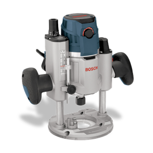

Arrange all three parts as shown in the picture and cut plywood accordingly. Also leave some bleeding space. Clamp laser cut piece with plywood (edge to edge) tightly. I used Bosch router with flush trim bit with the speed between 5-4. Go slowly and carefully while using router. Wear all safety gears to protect yourself.
For top
To make a hole inside the surface of the material, make a hole using drill wide enough for router bit to pass through. Start the router and make the cut slowly.
Important :
Router does not give 90 degree edge, for that Use the T Bone slots in you drawing files and cut accordingly. If you are making it with CNC machine, you have to make T bone slots and give commands to the machine. I want to avoid T bone slots, so I filled the edges to 90 degree very precisely with sander (you can use sand paper of grade 80)
