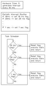

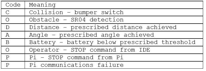

The Arduino control scheme is centered around two main elements; a task scheduler and a state machine. The task scheduler is driven by a periodic interrupt generated by timer 5 every 10 milliseconds. The interrupt service routine sets a flag corresponding to the time interval since last called. Flags are set corresponding to 10 ms, 20 ms, 50 ms, 100 ms, … 1 second. The main program loop consists of the task scheduler checking each of these flags and, if set, executes the task assigned to that time slot. The end result is that certain tasks such as closed loop speed control can be executed at higher rates whereas other tasks such as battery monitoring can be executed at much slower rates.
The second major software element is the state machine. YAAR is always in one of several states for example, stopped, going forward or going backwards. The state machine constantly monitors all inputs related to the current state and if anything has
changed, appropriate action is taken. Many events are interrupt driven which reduces the microcontroller overhead and increases the execution rate. The task scheduler executes the state machine task every 10 milliseconds.

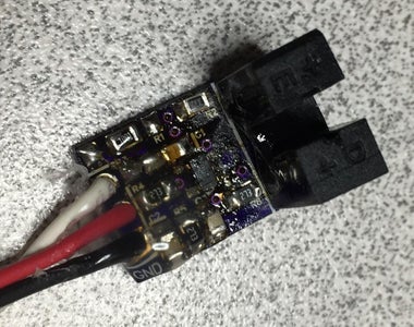

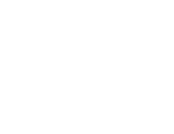

Step 6: Encoders
The slot encoder is a simple circuit. Although you can purchase slot encoders for the Arduino robot for $1 on AliExpress, there are a couple of drawbacks to the ones I have tested. Biggest problem is that they bounce. They are large and they consume a lot of current. This circuit eliminates bouncing with positive feedback around the op amp.
The slot encoders are key to the design of YAAR. They enable accurate speed control and tracking. The circuit shown is compact, low power and bounce free. The circuit operates from 3V to 6V.
Along with the encoder is an improved encoder disc with 50 holes instead of the usual 10. It is unfortunate that there is no practical method of attaching the encoder disk to the end of the motor shaft instead of to the wheel shaft. Getting as much speed information as quickly as possible is key in order to achieve smooth low speed operation. Fifty holes was the maximum my laser cutter would cleanly cut. The disc is cut from 1/16” ply. Attach the disk with a 2-56 or a 2mm screw to the opposite end of the wheel shaft. The PWB should be fabricated on .032” stock with 2 oz. copper.

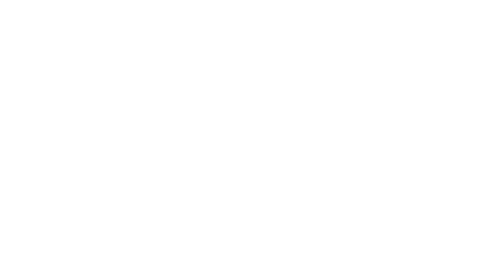

Step 8: Power Supply
The power supply is a switch mode buck converter that regulates the 7.4 Volt 2S LiPo battery down to 5 Volts. Power to the system is started with the press of a pushbutton. Shutdown is accomplished with the same pushbutton – just like your PC. This is important because just as pulling the plug on your PC is not recommended, neither is it recommended for the Raspberry Pi. Why not just switch off the power? Because the Pi has a lot of housekeeping to do in order to shut down. If this process is interrupted at the wrong time, SD card files can be corrupted. The power supply plugs directly into the 40-pin header of the Pi and is controlled by the Arduino. Note that when the pushbutton is pressed, power to the Power Distribution Board is being supplied through the pushbutton, then through the diode to the enable pin of the power supply on the power distribution board. After the Arduino boots up (which takes about a second), the Arduino will control the enable pin through a second isolation diode.
  • Attaches directly to Pi 20 pin header
  • 20 Volt max battery input
  • 3 Amp output
  • Trimpot adjustable from 4.95 to 5.48 Volt output
  • 92% efficiency
  • 2 cell LiPo supply

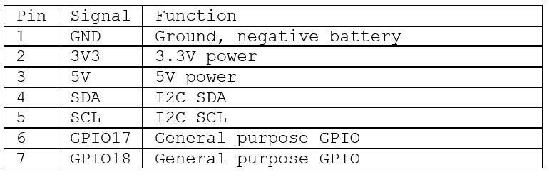

The power supply is based on Diodes Inc. the 3 Amp AP62300T switch mode regulator. Originally, I had designed the power supply to use the 5 Amp Texas Instruments TPS565201 regulator. However, after my initial prototype units were working, I tried to order more only to discover that the lead time had stretched to over a year. I chuckled to myself that my little project had contributed to the “chip shortage” that was crippling the auto industry. Fortunately, the AP62300T is almost a drop-in replacement. All of my measurements of the Raspberry Pi’s current draw (with camera) averages less than 1 Amp with brief excursions during startup of 1.75 Amps so the AP62300T will suffice nicely. There are small differences in reference voltages and enable pin control requirements. Additionally, there are two versions; the “T” and “not T” version with different reference voltages. It doesn’t matter – the schematic shows the correct resistors for each version. As with most components purchased from AliExpress, data sheets are wishful thinking. None of the Chinese sourced caps have exploded and the 7x7x3 mm inductor seems to be universally rated over 5 Amps. With the resistor values shown the output ranges from 4.95 V to 5.48 V (using the “T” version). Be careful when adjusting the trimpot, if you don’t have a non-conducting screwdriver, don’t adjust while plugged into the Pi – inserting a metallic Phillips screwdriver into the slot changes the voltage. After R1 is installed, the power supply will not turn on unless the EN pin is pulled high so install R1 after you have tested and adjusted the unit. I have adjusted my unit to 5.1 V with a 5 Ohm load. The power supply will maintain regulation unless the battery voltage falls below 6.5 Volts at which point the 2 cell LiPo battery will be over 90% depleted. The AP62300T is rated for a maximum input voltage of 20 Volts.
It turned out that the control connector is best oriented at 90 degrees. This covers up the voltage adjust trimpot making adjustment tedious. Turn the power off when adjusting the trimpot. The connections to the Hardware Control Unit are as follows: - see illustrations

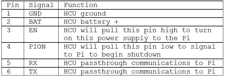

The power supply also has provisions for an I2C connector. The connector attaching the power supply to the Pi obscures the SDA and SCL signals so they are recreated at the I2C connector together with a couple of control signals: - see illustrations
You may have noticed that the battery is always connected to the system which could result in substantial leakage current. The leakage current is measured at 10 uA which amounts to years from a LiPo 18650 battery. The PWB should be fabricated on .032” stock with 2 oz. copper. Lastly, because the Arduino takes about a second to boot, you will have to hold the pushbutton down until the sustained beep begins or the laser diode begins flashing, this means that the Arduino has booted.

Step 10: Raspberry Pi
The Raspberry Pi serves as YAAR’s “Brains” and communication hub. Currently commands are sent form a PC terminal (PuTTY) via SSH over Wi-Fi to the Pi which are relayed over a serial link to the Hardware Control Unit. Progress is monitored on the PC through the camera connected to the Pi using a low latency UV4L software link into a browser window.

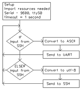

At this point I must confess that I am not a Python / Linux programmer. The first bit of Python code is a simple sketch that monitors an input from the Arduino and executes a shutdown command if the signal goes low. This was an easy hack taken from pushbutton shutdown code found in many places on the web.
The second bit of code is easy in principle but took a while to get working correctly. Basically, the code sends any input from the SSH port to the UART and sends any input received from the UART to the SSH port. Sounds easy enuf, huh?
#!/usr/bin/env python3
# non blocking input from SSH
# without "timeout" any noise will hang program
# This is a Pyton3 sketch, the .py file type is removed so it can be invoked easier
import sys
import select
import serial
from time import sleep
ser = serial.Serial("/dev/ttyS0", 9600, timeout=1) # timeout=1 second
while True:
    while sys.stdin in select.select([sys.stdin], [], [], 0)[0]:
        fromSSH = sys.stdin.readline() #get input string from PC via SSH
        if fromSSH:                    # if not empty
            fromSSH += '\n'            # add lf, needed for parseInt()
            toUART = fromSSH.encode('utf-8') # convert utf-8 to bytes
            ser.write(toUART)          # write out ascii bytes
            sleep(0.1)                 # time for Arduino to reply
    else:
        if ser.inWaiting() > 0:        # anything from Arduino?
            fromUART = ser.readline()  # '\n' terminated line, bytes
            toSSH = fromUART.decode()  # convert bytes to utf-8 string
            print(toSSH)               # send to PC via SSH
Here is an overview of the actions and items that must be installed on the Pi:
  1. Enable Wi-Fi
  2. Enable and test SSH communications to your PC’s terminal program (PuTTY host name raspberrypi, Port 22, Connection type SSH, Login as: pi, Pi@raspberrypi’s password: default is raspberry unless you changed it)
  3. Install and test Python shutdown.py code – use a pushbutton to ground to test
  4. Make shutdown.py execute on startup
  5. Install and test UV4L
  6. Install and test robot.py – at this point you should be able to connect to YAAR and communicate to the HCU over Wi-Fi / SSH / PuTTY

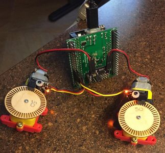

Bench test the HCU first. Attach the Arduino to the Power Distribution Board and connect the micro-USB. Invoke the Arduino IDE and load the code. Do not attach anything else to the HCU. Power will be supplied by the USB. Invoke the IDE serial monitor and confirm that the menu is presented.
Next attach the motor control module and the two motor assemblies to the HCU. The motors can be tested by sending forward and reverse commands. Remember that power is being supplied by the PC USB port so limit your speed. Mine runs out of juice at about 25 cm/sec. Check that the encoders are operating correctly by putting a bit of post-it note on each wheel and verifying that the motors are, in fact, tracking by noting that the relative position of the marker is unchanged. Problems can be caused by misalignment of the encoder and encoder disk or an obscured (or partially obscured) slot.
Attach the sensor module and connector SIG2. The laser should start blinking. The ultrasonic range finder can be tested using report 3.
Attach the power supply to the SIG1 connector and the SIG1 connector to the HCU. Apply 7.4V power to the power supply. Confirm proper operation of the bumper switches and the pushbutton. Whenever the STOP state is entered, the HCU sends a code in binary representing the reason (CODABOPP):

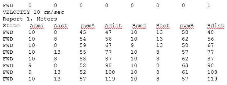

Click on the data input window in the monitor and enter a command such as “f<ENTER>” for forward then “v10<ENTER>” for speed. There are 7 built-in diagnostic reports such as “x1”, the one shown below (see illustrations). Note that the basic commanded speed is 10 cm/sec but each motor is modifying the commanded speed slightly as the steering task is attempting to keep the track straight , Adist = Bdist. There are 7 reports:
  1. Motor information
  2. Steering
  3. General
  4. Ping
  5. Spin
  6. Power control
  7. Mechanical & menu
Entering any command without an expected argument will set that argument equal to zero, so invoking report 0 will turn off any active report. You will have to examine the code to see the meaning of many of the columns as the abbreviated titles can be obtuse.

r<ENTER>     Change track to right 0 degrees (straight ahead)
s<ENTER>     Enter the stop state
r360<ENTER>  Enter the spin state, rotate in place right 360 degrees
Steering task is not invoked in the backup state resulting in the same speed command to both motors when in reverse.
