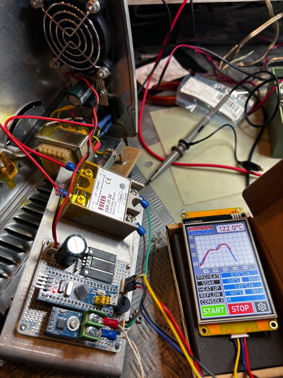

First of all I mounted all the components on a perfboard. The power supply is obtained from a 220V to 12V transformer (the classic old way) with a rectifier and some capacitor. The 12V power is to supply the fan that extracts heat from the zone with electronics, in order to keep the components, and mainly the Solid State Relay, cool.
The 5V power is from a 20 years old (but still valid) DC-DC Texas Instruments hybrid module (datasheet attached).
To mount the thermocouple adapter more appropriately I desoldered the original pin strip and mounted a vertical one.
As can be seen on the schematic, the project I follow is that of Polihedron, which adds the buzzer, very useful to quickly knowing when the cycle is finished and it's time to open the door. Unlike that, I didn't use the level shifter to drive the solid state relay. Testing the SSR with an external power supply, I verified that it also switches with 2V, the GPIO of the Blue Pill is perfectly capable of driving it directly both in voltage and current. I also tried to drive the buzzer directly but with bad results, the GPIO doesn't have enough current to drive it, you really need a mosfet.
There are no more significant difference between the hardware part of the projects. The software side of the Polihedron project, however, is very interesting. Also the Kp, Ki, Kd parameter he chose as default for the control loop are perfect for my system.

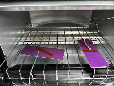

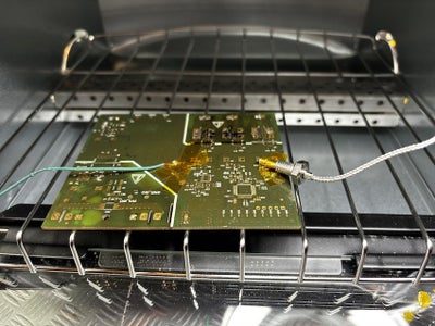

After mounting the control board, I was able to test the thermocouple, at least with the Nextion display simulation software (the physical display was delivered some time later). The probe suggested by Vulcaman (part of the kit with the MAX6675 module) is very good and accurate but with a response time that is too slow due to the mounting bolt that includes it. This behavior is not at all compatible with closed loop control for a oven that must follow a profile with rapidly changing ramps. The 1kW heater of the oven I choose is capable of following the required profile, the probe must also be able to do so.
So I decided to cut off the bolt case and directly expose the junction. Now, comparing it to another thermometer it is very similar, both in accuracy and response time.

After the actual display arrived, I repeated the tests with all the components. The main power switch is mounted on the back of the case. The control board is mounted on an aluminum plate which also acts as a heatsink for the SSR. After a certain period of intensive use there is only a small increase in temperature.

The small size is useful for not taking up too much space in my laboratory. The 1kW heater is quite correct for a 10L volume, less power means not enough heat too quickly follow the desired profile. Do not choose the 600W, cheaper ones. With larger oven size, also increase the power to 1.5 or 2kW heater. The more the better, the closed loop PID controls the power actually needed to have the right temperature, modulating it. With a higher heater power it stays ON for less time but it is also able to react more quickly to any unexpected event. Just notice on the images that only at higher temperatures the profile is followed slightly slower than necessary. A little more power would be better.
