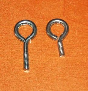

1 Eye Bolt with Nuts (http://www.homedepot.com/h_d1/N-5yc1v/R-100177233/h_d2/ProductDisplay?langId=-1&storeId=10051&catalogId=10053) $1.00;

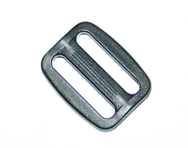

2 slide rings (1 comes with lashing strap, so buy 2 of them and you will be good :));

Step 2: after that you will add the slide ring to each side to the strap. Ring facing out;

Step 9: now connect the eye bolt to the hook....
- Step 10: ...and then everything to the camera.

Since most of my things are working in progress, right after I finish this camera strap I found a better eye hook.
Note on the picture the the thread goes all the way to the hook. It makes possible to make the eye hook shorter, therefore more compact.
