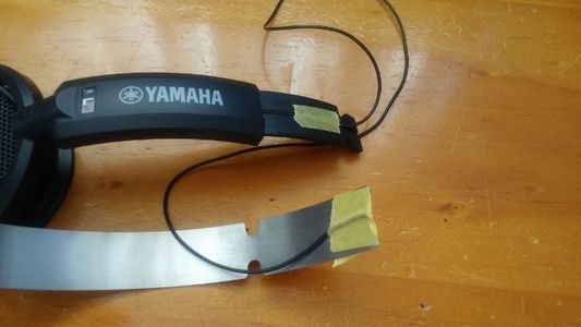

Step 4: Wiring Through the Headband
  1. Slide the slider away from the earcup as far as possible.
  2. Leave some wire slack inside the slider rail, behind the "YAMAHA" logo
  3. Tape and secure the wire onto the slider in this extended position.
  4. Tape the other end of the earbud wire to one end of the metal band.
  5. Now slide this taped end through the foam headband.
  6. Un-tape the metal band, pull the wire through the foam until the two circle dimples on slider line up with the metal band.

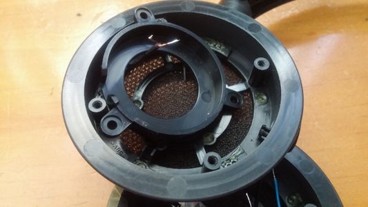

Step 5: Wiring to the Right Earcup
  1. After confirming you have enough earbud wire to reach the right earcup, remove the tape on the left slider, reattach the two clamping pieces with screws. The left earcup and slider should now move freely.
  2. Disassemble the right earcup, cut and desolder the wire, keep the strain relieve
  3. Now reverse the steps in Step 3, and wire the earbud wire into the through the right slider, hinge and into the right earcup.
  4. Feed the wire through the plastic ring shown in photo.
  5. Trim the earbud wire but make sure it reaches the solder pads.
  6. Strip and tin the enamel wires, solder right signal and ground to the respective pads.
Test the solder joints by plugging in a music player, both earcups should have sound, make sure to do left-right headphone test
