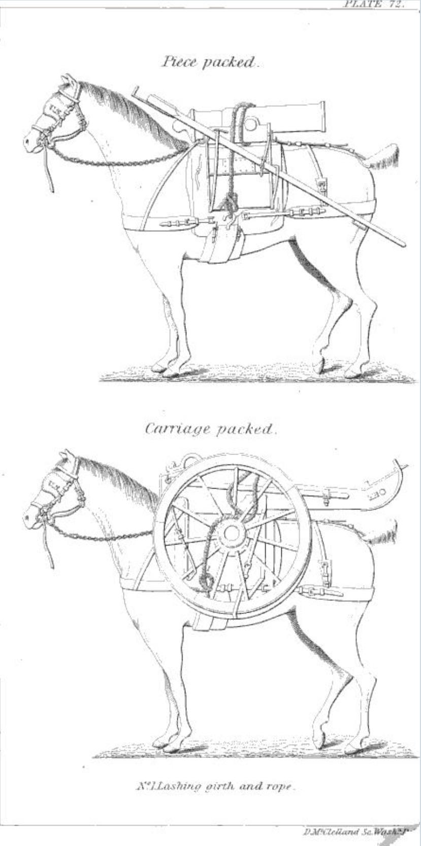

Step 1: Your Scale Drawings
For those with the big question…
In order to be federally legal the replica must be modeled before 1898 and be muzzle loaded not capable of firing fixed ammunition.
~ no breach loading
~ no exploding or incendiary ammunition
- modeled of cannon produced before 1898.
Now that your mind is at ease…..
Figuring out which carriage to build will be up to your artistic eye. Inspired by spaghetti westerns, I chose a prairie carriage from the Indian wars of the 1860’s.
Deciding to model after an 1841 Mountain Howitzer leaves me with several options to generate the carriage and the barrel. I’ve opted for the prairie carriage, as it was designed to be portable and it’s firing tube was robust and easy to operate.
Short and simple : do a night or two or three thousands worth of visual & mental homework and make a dream come true.

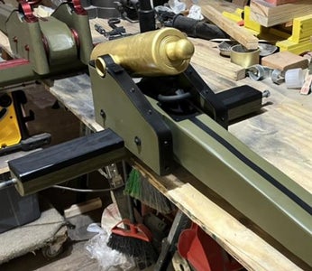

To secure the barrel to the carriage I decided to use the 2” riser clamps that were discarded earlier that week. Routing a proper channel was key to sinking the clamps and streamlining the reinforcement straps to the cheeks flush.
Once the clamps were fit I moved on to the reinforcement straps. I chose 1/8” thick by 1 1/2” wide steel strips that were found in the trash pile during my flat lay I generated an idea of where I wanted to sink the lag bolts to hold it in place and marked them with a sharpie. Once one was marked out, they were clamped together and drilled to the appropriate size for the lag bolts that were to secure it to the cheek. Once they were drilled they were in clamped and I used the original cheek mold to shape the metal to its surface, once both were shaped I put them to the side to be painted.
I used utility pulls found in a jobox as the rear pull handles.
An offset 7/8 box wrench cut in half as the horizontal stabilizer loop.
1/4” thick x 3/8 wide flat bar trimmed to 7” and bent inwards at 45* to secure the draw rope & 2” “U” to hold horizontal stability bar.
Broken lathe wheel that was epoxied back together as the elevation wheel.
A knob from one of the cabinets that had a scratch and was tossed, acts as the elevation screw rest.
All of these items were destined for the paint booth and followed a traditional Matt color scheme of of green and chalkboard black.
Step 8: Assembly
Once you have let your paint cure for a few days, begin assembling your masterpiece.
Display it with pride and know every dad on the block envies you as they drive past and aspires to be you as the hear it roar from down the street.
