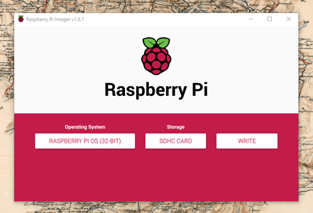

First, you will need to install the most up-to-date Raspberry Pi OS on your Raspberry Pi SD card. There's a tool called "Raspberry Pi Imager" that does it in no time and it's very straightforward to use. Get it [here](https://www.raspberrypi.org/software).
Open the Raspberry Pi Imager tool, you need to choose the OS you want to install, and the SD card you want to use for the Raspberry Pi. I chose the default "Raspberry PI OS" which is based on Debian and optimized for the Raspberry Pi hardware.
Once the flashing process finishes you can remove the SD card from the reader and insert it inside the Raspberry Pi to boot it up for the very first time.

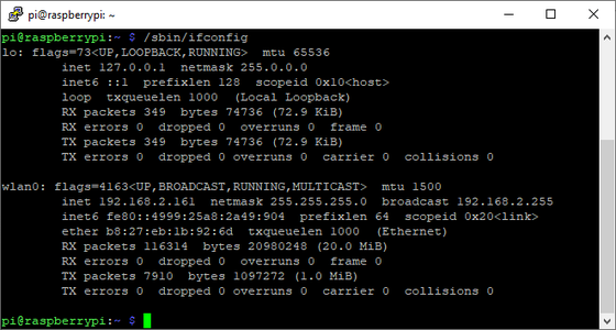

You have multiple ways to get the Raspberry Pi:
- Run a "*/sbin/ifconfig*" command inside the Raspberry Pi.
pi@raspberrypi:~ $ /sbin/ifconfig
lo: flags=73<up,loopback,running> mtu 65536
inet 127.0.0.1 netmask 255.0.0.0
inet6 ::1 prefixlen 128 scopeid 0x10<host>
loop txqueuelen 1000 (Local Loopback)
RX packets 349 bytes 74736 (72.9 KiB)
RX errors 0 dropped 0 overruns 0 frame 0
TX packets 349 bytes 74736 (72.9 KiB)
TX errors 0 dropped 0 overruns 0 carrier 0 collisions 0<br></host></up,loopback,running>
wlan0: flags=4163<up,broadcast,running,multicast> mtu 1500<br></up,broadcast,running,multicast>
inet 192.168.2.161 netmask 255.255.255.0 broadcast 192.168.2.255<up,broadcast,running,multicast> inet6 fe80::4999:25a8:2a49:904 prefixlen 64 scopeid 0x20
ether b8:27:eb:1b:92:6d txqueuelen 1000 (Ethernet)
RX packets 116314 bytes 20980248 (20.0 MiB)
TX packets 7910 bytes 1097272 (1.0 MiB)
TX errors 0 dropped 0 overruns 0 carrier 0 collisions 0</up,broadcast,running,multicast>- Run a ping command from another computer connected to the same network, use the default Pi name: "raspberrypi"
C:\Users\manu>ping -4 raspberrypi<br>Pinging raspberrypi.local [192.168.2.159] with 32 bytes of data: Reply from 192.168.2.159: bytes=32 time=88ms TTL=64 Reply from 192.168.2.159: bytes=32 time=5ms TTL=64 Reply from 192.168.2.159: bytes=32 time=5ms TTL=64 Reply from 192.168.2.159: bytes=32 time=5ms TTL=64
- Access your Home Router information, it usually shows a list of devices connected with the IP assigned.
So now that you have the IP you can use Putty to access it. You no longer need a screen!

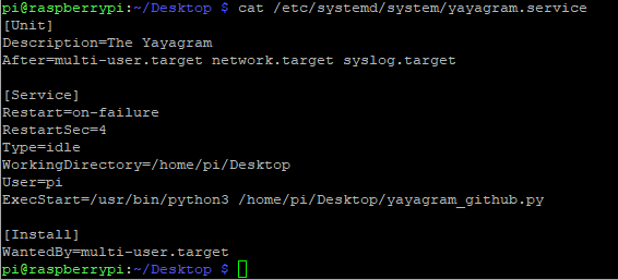

Step 5: Creating the Systemd Service
To execute the yayagram.py script on the Raspberry Pi and restart it in case of unexpected crashes we are going to create a Systemd service.
Here you can read more about how to do it with extra details, but I'm going to give you just what you need to get it running. Please follow the next steps:
- Create a file at "/etc/systemd/system" called *yayagram.service*, and add the following content:
[Unit] Description=The Yayagram After=multi-user.target network.target syslog.target [Service] Restart=on-failure RestartSec=4 Type=idle WorkingDirectory=/home/pi/Desktop User=pi<br>ExecStart=/usr/bin/python3 /home/pi/Desktop/yayagram.py [Install] WantedBy=multi-user.target
- Reload the services list:
sudo systemctl daemon-reload
- Start the yayagram service:
sudo systemctl start yayagram.service
- And, enable it so it starts the next time you reboot your Raspberry Pi:
sudo systemctl enable example.service

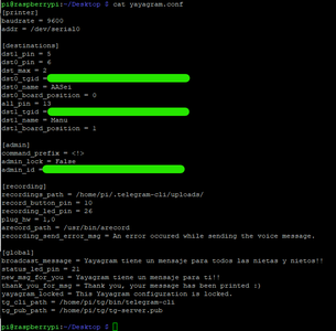

Step 6: Yayagram Configuration
The yayagram needs a "yayagram.conf" configuration file where the python script is located.
This configuration file contains useful parameters to set up your Yayagram based on the pins you used that can be obviously different from the ones I used.
This is an example of a Yayagram with two grandchildren, a microphone, a push button, two LEDs, and a printer.
[printer] baudrate = 9600 addr = /dev/serial0 [destinations] dst_max = 2 dst0_pin = 6 dst1_pin = 5 all_pin = 13 [admin] command_prefix = <!> admin_lock = False<br>[recording]<br> recordings_path = /home/pi/.telegram-cli/uploads/ record_button_pin = 10 recording_led_pin = 26 plug_hw = 1,0 arecord_path = /usr/bin/arecord recording_send_error_msg = An error occured while sending the voice message.<br><br>[global] status_led_pin = 21 broadcast_message = Yayagram tiene un mensaje para todos las nietas y nietos!! new_msg_for_you = Yayagram tiene un mensaje para ti!! thank_you_for_msg = Thank you, your message has been printed :) yayagram_locked = This Yayagram configuration is locked. tg_cli_path = /home/pi/tg/bin/telegram-cli tg_pub_path = /home/pi/tg/tg-server.pub
Let's review the takeaways of this config file.
Printer
"baudrate" Is the printer baud rate. It's usually 9600 or 19200 bauds.
"addr" is the printer path, it's usually "/dev/serial0" by default.
Destinations
The most important part of this configuration section is the "dst_max" parameter, it's the number of grandchildren your Yayagram supports. Then, for each grandchild, you have to define their GPIO pins. As you can see this example uses pin #6 and #5 with the "dstX_pin" variables. Finally, the "all_pin" is the GPIO pin you use to connect the special socket to communicate with all the grandchildren at once.
That's all. Later, we will use some Telegram commands I wrote to easily adding grandchildren to the Yayagram.
Admin
[admin] command_prefix = <!><br>admin_lock = False
Nothing mandatory to change here. "command_prefix" is used to send the Yayagram commands to manage the grandchildren supported. "admin_lock" is used to prevent modifications to the configured grandchildren.
Recording
[recording] recordings_path = /home/pi/.telegram-cli/uploads/ record_button_pin = 10 recording_led_pin = 26 plug_hw = 1,0 arecord_path = /usr/bin/arecord recording_send_error_msg = An error occured while sending the voice message.
In this section, there're a lot of things to configure.
"recordings_path" Is where the tool is going to store the recordings to send. Make sure the path exists.
The "record_button_pin" and "recording_led_pin" are the GPIO pins used to connect the button and the led.
The "plug_hw" parameter is the arecord card and device numbers, check above the "Microphone" section to know more.
"arecord_path" is the path to the "arecord" tool, change it if it's not located at the default path.
Finally, "recording_send_error_msg" is an informative message to alert about failures recording and sending the voice message.
Global
In this section first the "status_led_pin", a blinking led, choose the GPIO pin used.
The rest of the configuration is informative messages you can use to customize the Telegram messages sent.
Finally "tg_cli_path" and "tg_pub_path" are the paths to the "telegram-cli" tool location and the Telegram pub file.

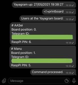

Step 7: Telegram Custom Commands
As retrieving the Telegram User ID and accessing the Raspberry to store is hard to accomplish, I created a simple set of commands to configure everything related.
<!>addme
Send this Telegram message to the Yaya contact and the Yayagram will add your user to the grandchildren board list. Each grandchild has to send this message to do the check-in.
<!>printboard
This command prints the list of grandchildren added to the Yayagram board. It's really useful because it prints the position of each grandchild, making it super easy to later label the jack sockets.
<!>removeme
If you don't want to be at the Yayagram board you can send this message and the Yayagram will remove you from the list. Your spot can be used by another grandchild.
<!>addmeasroot
This command adds the person who sends the message as the "yayagram-superuser", this user has special permissions to lock and unlock the Yayagram board modifications. You can only set a superuser when there's none configured. The superuser also receives an automatic message each time the Yayagram is rebooted.
<!>lockedits
Only the superuser can run this command. It blocks the Yayagram from further modifications, no adding no removing grandchildren.
<!>unlockedits
Only the superuser can run this command. It unblocks the Yayagram from further modifications, adding and removing grandchildren operations are back available.
