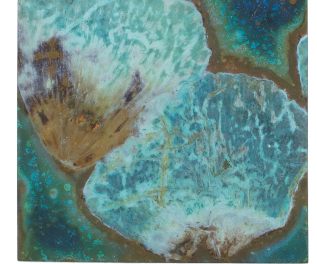

Step 5: Make It.
- Thoroughly mix 3 teaspoons of Yellow Ochre with 1 cup of water.
- Spray or dip or paint Yellow Ochre onto the copper.
- Sprinkle a small amount of salt onto the copper.
- Let cook (sit) for 1 hour.
- Let completely dry (24 hours).
- Gently wash in warm water.
- Let dry.
