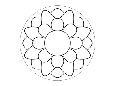

Step 1: Draw a Mandala
According to a book I have, the word "mandala" in Sanskrit means "circle." Monks created the mandalas as part of their traditional spiritual training. It is constructed in such a way to draw the attention continuously to the center and back to the outer frame again. Drawing a mandala is basically repeating a design or symbol within several circles (real or alluded to). The repetition of the designs is meditative.
Because I'm limited in the 26 gauge wire I have, I decided I would make my sunflower mandala small, about 4" in diameter.

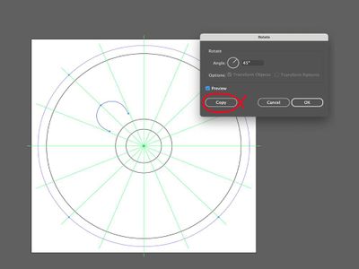

In Illustrator I drew a small circle, copied and pasted in front, and while holding option+Shift (on a Mac) pulled the circle out. I did this a few times to give myself some guidelines. I created a larger circle outside of all of those to help rotate and duplicate the shapes I draw inside my mandala. I made it a new color to let me know it's not part of the mandala.
Then I created a long straight line and centered it both vertically and horizontally with those circles. I then copied, pasted in front, and rotated them every 22.5 degrees to give myself 16 equal divisions of the circle to create my designs. I made those a different color and grouped them.
In thinking about having to bend wire into the grooves I will be making, I decided I wouldn't do sharp points or very small designs that I would have trouble working with.
With that in mind, I drew a half petal shape just outside one of my circles. (NOTE: I'm only using strokes because I will just score the lines on the laser instead of engraving. I have a trick for making thick score lines that I'll discuss later.)
I started at the top center guideline and drew a lovely curve down toward the inner circle. Then I copied, pasted in front, hit O for my reflect tool, selected the center point at the top of the curve, then reflected the half curve to finish the petal. I then joined the two top points (Command+J).
Then I selected that shape and the very outer ring, selected R for rotate, then 45 degrees and selected Copy at the bottom of the rotate menu (see 2nd image above). Then I hit Command+D six more times to repeat the petal all the way around the mandala.
Because this is a meditative practice, I will let you decide what shapes you want to draw for your mandala. You can download the one I created below as well.

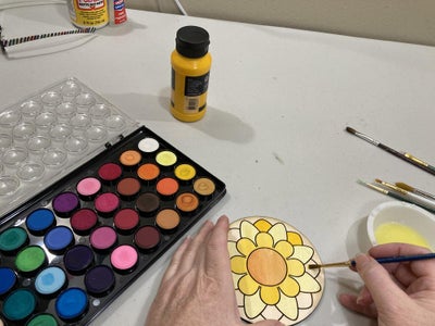

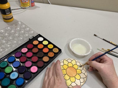

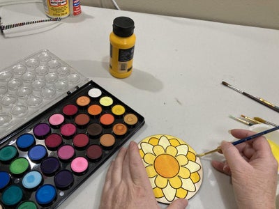

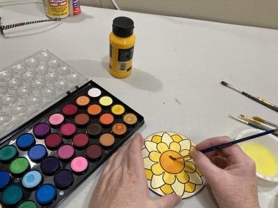

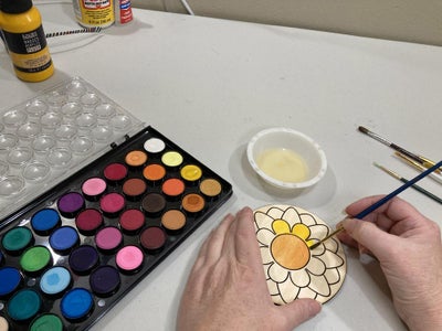

Step 3: Paint the Mandala
Use a hair dryer or can of compressed air to blow out any dust or soot from the mandala. Then get out your yellow watercolor paints and have fun.
I use watercolor paint because it works like stain in that it shows the wood grain underneath. I like seeing the wood grain. Plus it doesn't add any texture or depth to your wood.
Don't worry if you get paint down into the grooves where your wire will go. It won't show when you're done.
Give it some time to dry before the next step.
