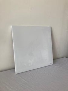

  1. 14" by 14" white board

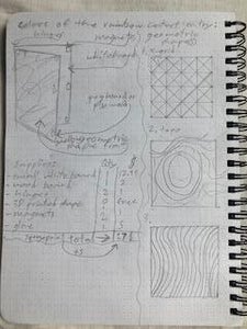

Step 1: Planing:
When planing for this project I wanted to look for a semi-easy build that would improve my 3D modeling skills and be functional. instead of going out into the world to look for an idea I looked at chatgpt an AI that gave me many promising ideas but nothing great or unique; until it gave me an idea for a functional art piece that doubles as a whiteboard. Some of the ideas I came up with include a grid filled with triangles, a Topo map, or some ocean waves. The best design that stuck out to me was the Topo map because of its nice dynamic design. I also figured out how much this project would cost me by what item I wanted, the quantity, and by researching prices near me.

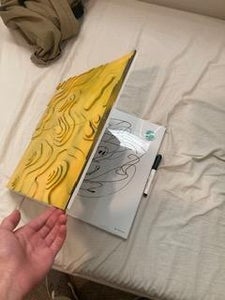

Step 2: Foam Cover:

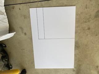

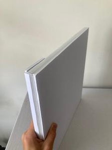

First cut your foam board so that it is 14" by 17". Next cut the slots that will form the hinge of the white board cover and do this so that the foam board raps around the left edge of the white board. The pictures above shows what the hinge rows should look like.

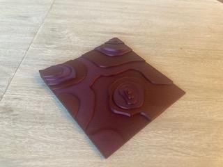

When 3D modeling this Topo map, I started by looking on the web for a simple yet dynamic looking Topo map. Next I used the downloaded image to trace the outline of my project. Using this outline I extruded each part a tenth of an inch away from each other. The result was a clean sharp cornered design from which I used to 3D print it. This Topo map is not a topography of any portion of land but does show great features of what a Topo map might look like.

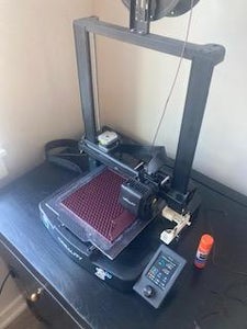

Step 4: 3D Printed Parts:
At the start of the "pull it out of the computer" part of the project I had to cut my model into four equal parts, each one being a 7" by 7" square because my 3D printer can only 3D print up to I think 9" long and wide. Each part taking roughly about six to seven hours to print, totaling around a little over a full day of printing. To stop the print from sliding around, I used a glue stick to make a more sticky surface for the plastic to stick to the print bed. This made a great first layer. When 3D printing I found that playing around with the infill settings best lowers the print time.

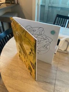

Step 5: Paint and Assembly

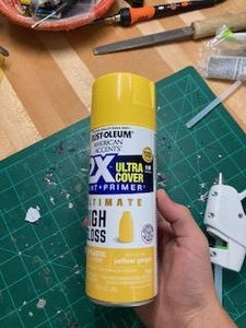

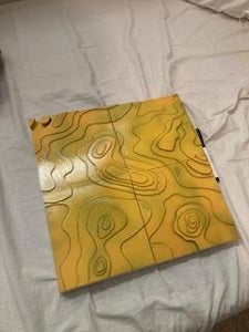

First spray paint the 3D printed parts with the yellow spray paint of your chose or any color with as many coats of paint as you like. For this project I did one coat of paint, as it made a more roughed up and non perfect look to it

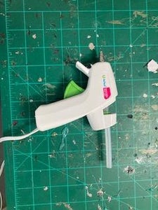

Next I waited for the spray paint to dry and then used the hot glue to attach each 3D printed tile onto the foam cover. With this the project was finished and all that remained was to attach it to the wall using the included wall mounting brackets.
