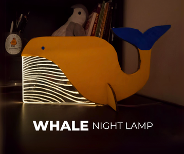

I had some pieces of 5mm thick plexiglass left over from a previous project, so I decided to get creative and make a unique lamp out of them. This particular lamp is shaped like a whale and emits a warm, cozy yellow light. It is a perfect addition to your bedside table for a relaxing evening of reading or simply creating a calming ambiance. In this tutorial, I will explain the steps to create this charming lamp. From selecting the right materials to assembling and wiring the components, I'll provide detailed instructions and tips to help you craft your own beautiful whale-shaped lamp.

Finally, it's time to complete your whale-shaped lamp by adding a few finishing touches. Attach a nice long wire to the LED strip, ensuring it has enough length to comfortably reach an outlet. This will provide you with the flexibility to place the lamp wherever you like.
Next, slide the plexiglass into its designated slot. It should fit securely without the need for glue, allowing you to easily remove or adjust it if needed.
Once everything is in place, turn on the LED strip and enjoy the cozy, warm light emitted by your whale lamp!
