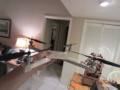

I built my quadrotor with a friend. I used some thin aluminum angle bracket from Home Depot as the struts. The motors spinning will produce a moment about the center of the axis of the strut, so they will tend to torque to the side a bit. It gets worse when the struts get longer, so this approach will probably only work for smallish quadrotors. For the platform, I just used some scrap Lexan I had laying around. It's a bit too thick and adds a little too much weight, but the thing still flies.

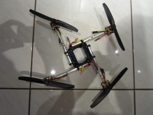

My friend took a different approach and 3D printed a basket for his electronics and used some aluminum tubing with holes drilled to lower the weight.

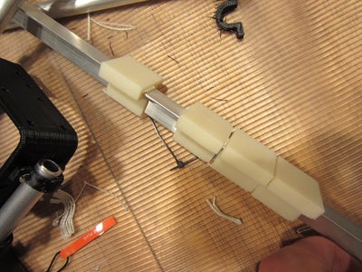

We both ended up 3D printing motor mounts using a MakerBot. Mine were designed to slide on the angle Aluminum and be fastened down. The quad with tube struts had a small platform for each motor and two printed fasteners to hold on to the tube and get screwed into the motor platform. If you don't have a 3D printer, you can still order 3D prints of motor mounts from a 3D printing service and they won't be very expensive.

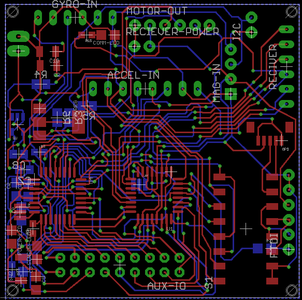

I know that Ardupilot exists and there are tons of tutorials for doing this with an Arduino, but I wanted to design my own board for the practice and because I wanted it to be really cheap. So, I made a board that is based on an ATMega328 and has a 3 axis gyro, 3 axis accelerometer, and magnetometer. You can either buy the MCUs and then flash them with the Arduino bootloader, or you can buy them preflashed from ebay and just solder them it, which is what I did because I didn't have a programmer.
Here's the schematics, layout, and code.
This boards dimensions were chosen specifically to be used with Itead Studio's PCB service. They will do 10 boards for $10, including silkscreen and soldermask. They're not as accurate as Advanced Circuits or another US board house, but they're great for small cheap projects when "good enough" is ok. The github repo includes gerber files, so it is ready to send off.
The code includes a control loop that uses a Kalman filter to do stabalization in a PD loop. You will almost certainly need to change the gains, and there's no other way to do that than experimentation. We sat outside with the quadrotors tethered to the ground for a couple of hours and tried different numbers until it worked. The code should work on boards other than the one I provided, but you'll probably need to edit it a bit depending on the kind of IMU you're using.
