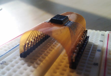

Also, make sure this is the right method for you. In my experience these circuits are very easy to fabricate. It is also possible to make very intricate designs (I use 0604 parts on a regular basis). However in my experience they are not very durable. I like it for prototyping, however, with time my circuits will accumulate tiny cracks where flexible and rigid materials meet. I personally love this method and I find the results beautiful, but if I want to make something rugged, I go with rigid PCBs. (btw. If anyone has suggestions on how to increase the lifespan of these circuits, I would love to hear them. DuPont sells various interesting materials which could be used to seal them, but I have never tested any of them. Some type of elastic coating might also help, but I myself have not done any testing in this direction yet.)

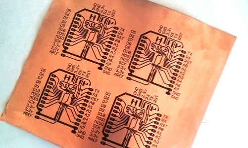

I use Eagle which is as powerful as it is counter intuitive. I recommend learning it, but if you just want to get your toes wet, you are probably better off using some vector-graphics software. If all else fails you could even use Microsoft Paint. Some things to keep in mind
- Only use black and white.
- Do not use gray-tones.
- It is generally a good idea to avoid diagonal lines, in order to minimize anti-aliasing problems.
- If you can, make your signal paths thicker than thinner. This will save you any headaches while etching & soldering.
- When exporting your image, do so with the highest possible DPI (I generally work with 600dpi.)
- In order to print it in the appropriate scale, you can use Microsoft Paint. Go to the options and specify the dpi before printing (Photoshop also does this, and other software too, I am sure. But I don't like installing extra software if I don't need to).
Step 2: Print Your Circuit
Before you print, clean the Pyralux with industrial alcohol. Fingerprints can lead to wax pealing off. You can cut the Pyralux to smaller pieces and then specify to print in that size. My prints usually are A6.
(The nice thing about this method is that you can do multiple test-prints on paper, and once you have it right, switch over to the Pyralux.)

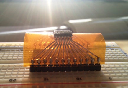

Step 5: Soldier It
Those tiny resistors? SMD capacitors? Surface mount components? Get out your pincers, listen to some relaxing music and soldier them. You can do it, no problem.
I generally first apply some soldier to all the pads. I then pick up LEDs, resistors, capacitors with thin tweezers and place them where I want them. Without letting go of the component, I heat the soldier, and let it flow into the component.
Surface mount components like the Atmega328p in the image above I usually attach to the circuit with some double-sided tape. Once it is in place I solder it, foot by foot, with a thin-tip soldiering iron (the tape just stays there once its done.)
I learned how to soldier smd components by following this tutorial.
NOTE: There is no pressing reason not to use Through-Hole Components as well. Just remember in your design to add them in as a mirror image, as you will be connecting them from the 'back' of the circuit (just punch holes where the feet go). I sometimes attach headers this way, though I prefer to attach them at right angles (as seen in the first two images) when possible.
