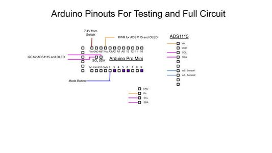

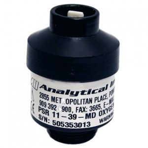

Step 2: Obtain Oxygen Sensor, Test I2C and ADS1115
These oxygen cells can run you over $100 new, but luckily most dive shops have a good supply of used ones. See: if they are used in rebreathers they must be replaced every year, but most of them last 2-4 years. Make friends with a local dive shop tech that services rebreathers and I guarantee you will be able to snag a few of them for free. I got my cells in exchange for making a few extra of these Nitrox sensors as gifts.
I also ordered one on aliexpress for around $25 and it worked just as well as the high quality ones I got from the dive shop.
The basic principle of the cell is simple: A chemical reaction occurs which creates a small voltage. The chemical reaction proceeds in proportion to the partial pressure of oxygen, thus, by measuring the voltage, you measure the partial pressure of oxygen. The trouble is, the voltage is quite small. The oxygen cell outputs anywhere from 6mV to 12mV in ambient air (21% oxygen) depending on how new it is.
Therefor, to measure such a small voltage, your arduino needs a little help in the form of an ADS1115 analog to digital converter board. This will be used to measure the small voltage from the oxygen cell and digitally relay the information to the arduino using the I2C bus.
So, the first thing to do is to connect the ADS1115 to the arduino and see if you can measure the small voltage from the cell. This is an important step because a lot can go wrong with I2C and you can verify the arduino can talk to the ADS1115 properly. I relied heavily on other how-to pages for this step. Here is a link to a good one.
You don't even need the battery for this stage. The Arduino should be able to do the job all by itself being powered through the USB port of your computer.

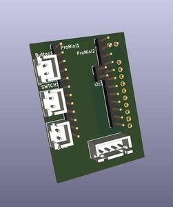

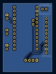

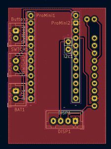

Step 3: Design and Order Custom PCB
This project was actually the first time I've used KiCAD (historically I have used upverter, but that project unfortunately has been discontinued), so I can attest that the program is exceedingly easy to learn and use for simple boards such as this.
Spend an hour or so watching some initial help videos, and then start designing.
Here is a link to the Github page containing KiCAD files and final gerber files I sent to AllPCB for fabrication.
I used the sparkfun Solder-able mini breadboard as an initial physical model for designing the project board and making sure all the JST connectors had enough space, so as long as the final board you design fits in a 1.3" x 1.8" (33mm x 45.7mm) shape then this will match with the slots on the 3D printed parts and will fit inside the case.
I ordered 10 boards from AllPCB and received them in about 10 days (DHL) for $41.55 CAD, so only $4.16 per board delivered! This would be cheaper in larger quantities, but I am only interested in making a few of them for now. Feel free to adapt the design as necessary.

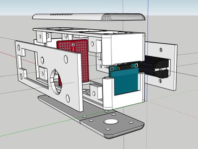

Step 5: 3D Print Case Parts
STL Files can be found here: https://www.thingiverse.com/thing:6300317
These were made using the free version of sketchup. There are a total of 9 parts to print and will use a total of about 130g of PLA.
I designed all the parts over a few weeks, and they had to undergo constant tweaks to make everything together properly. The final configuration is pretty good, but some feedback I have received is that the device is a little big. I will be working over the next few months on a version 2 which will shrink the case substantially. Stay tuned.
Please adapt the parts as needed. The most important aspect of these parts is that they fit with countersunk flathead M3 machine screws, and the hexagonal recesses fit the M3 nuts. I carefully tweaked the settings so that the M3 nuts would compress into the parts snuggly (proceedure described in the next Step) and capture the nut so that the case nicely screwed together.
Printer I used was a Flyingbear Ghost 5, with Ultimaker Cura as a slicer.
If you use a brim like I did, then you will have to trim this off. Most parts will print without supports, except for the bottom plate. There is a small recess that needs supports. The recess creates a little room for the programming pins of the pro mini. It also makes the plastic a little thinner in this area and allows you to see the color of the LED when the batteries are charging.

Step 8: Test Full Circuit Prior to Assembly
Before the entire assembly is screwed together, its good to test whether the system works. Plug everything together except the battery and the switch. Since we will be powering the arduino through the FTDI connection, we will just need the sensor, OLED, and button to operate.
This is the main chance to check the arduino code, make sure all the libraries are installed correctly, and to make sure that the screen is all setup right. If you used a different sized screen, the code has obvious places to change this setting.
If something goes wrong at this stage here is a chance to stretch your debugging muscles.
There could be a short due to bad soldering.
There could be a glitch in the code.
There could have been a mistake in the connector wiring.
Any number of tiny errors could cause a problem here.

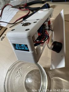

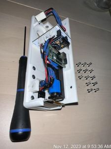

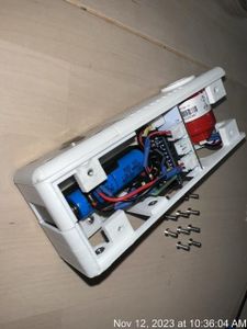

Step 9: Final Assembly of Nitrox Sensor
Careful with the countersunk screws. The 2mm allen key will not supply very much torque before stripping. Be gentle. Feel the nut engaging, and do not over tighten.
Fitting all the cables in the tight space can be a challenge. Hopefully you left enough slack to move them around and not too much slack so the cables take up too much space.
One of the last steps is to attach the side with the switch. When doing this, take note of the position of the battery charge board. There is a small slot that just fits the board and allows the entire assembly to click together. Prepare to jiggle this a little to get it to fit.
The last step is to attach the top. Be mindfull of the slot on the top assembly piece that will hold the main PCB. This prevents the PCB from jiggling around in the case and makes the entire assembly very tough.
Once it works, make sure that it reads 20.9% in open air. Then breath on it. If you breath slowly into the sensor the oxygen percent should decrease to 17-18% from the lower percentage in your breath.
