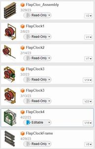

I decided to go as small as possible and the stepper motor here defines the size. It took several iterations to find the proper size of the flaps and the fixing rolls. I wanted to keep the distance between the flaps as small as possible, however due to the 3d printer inaccuracy I had to settle with the value of around 0.8 to 1.0mm (double nozzle size). I tried different ways, unfortunately they were not sustainable and stable for "mass" production.
In the pictures one can see the iteration steps. Not all steps are shown and I think I printed more than 10 versions of each part before I settled. During prototyping I noticed that the flaps are very light and they don't make the correct sound. Something that I didn't think of before the design. However in the final design the flap sound was good enough.
The frame design is not very complicated and I tried to find a balance between material usage and print speed. With less material usage the print time would increase and vice versa. In addition, mechanical strength is important too and I tried to find a suitable balance. Here again the aim was to reduce the size as much as possible.
