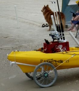

Yes, there are many designs out there with either rigid or folding frames that the kayak needs to be secured to or need to be inserted into the scupper holes. Wheels that handle loose soft sand well have to be large diameter or wide. Due to the width of some kayaks this makes the assembly quite tall and or wide. This is something a little bit different in that it is held in position by cords in tension but is towards one end of the yak to keep the width down. With the wheels towards the rear, some weight needs to be carried when dragging from the other end of the kayak.

With your kayak upside down slide the wheels on the axle rod and position the axle on the kayak in the position you want. The closer to the back, the narrower the frame will be but the heavier it might be to haul while the nearer to the center you place them then wider the frame will be and the easier it will be to pull. I positioned the wheels so they were inboard of the kayaks width so the cords could connect to the kayak without rubbing the wheels. If the wheels are wider then the blocks and cord will need to be placed inboard of the wheels.

Drill two blocks of plastic with one hole for the axle and another hole big enough to accommodate a knot in the cord you are using. Drill a hole the diameter of the cord to intersect this hole. Feed the cord into the hole and push the end out and tie a knot in the end and pull the cord back tight so the knot is in the hole but cannot pull through. Place the block on the outside of the wheels both sides and tie an S hook to attach to a deck feature. Adjust the hooks position until the frame is held tightly in place.

In the design step I positioned the stub ends cradling the hull about a wheel diameter from the end elbows so one wheel sits in the space. The other wheel sits outboard and the cords tie it together so not loose or lost parts. It also stands up on end nicely. The axle can be removed to make the storage space required a bit narrower.
Step 4: Project Complete!
Enjoy being able to cart your yak down to the waters edge more easily. Remember to load the cooler and any other heavy items at the back above the wheels to make it easier.
