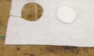

Step 1: Let's Cut the Fabrics
First, I cut 5:5 inches black vinyl circle. Then I used a pen to divide the circle into two as Yin and Yang. After that I cut half cotton part for the Yang (White). For the Yin(Black) part, I cut black vinyl.

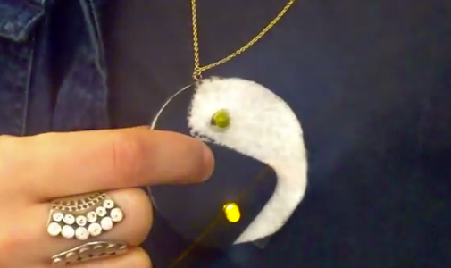

And then i hot glued the yin yang circuit with a chain.
Step 6: Final Step
Now, you can wear the necklace and press the sides the right(Yang) and the left side(Yin) to light up your emotional states.
