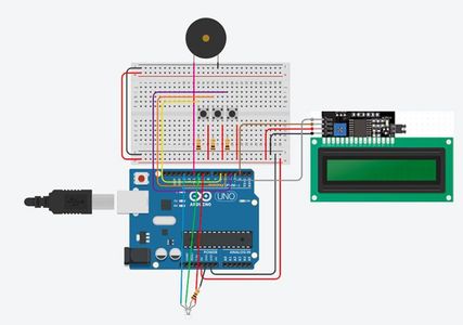

Step 1: The Circuit
Build the circuit like the picture above.
Note:
  • Red Wires are connected to VCC.
  • Black Wires are connected to GND.
  • Brown Wire is connected to D2.
  • Grey Wire is connected to D3.
  • Purple Wire is connected to D4.
  • Green Wire is connected to D5.
  • Yellow Wire is connected to D6.
  • Pink Wire is connected to D11.
  • Orange Wire is connected to D13.
  • Brown Wire can also be connected to SDA.
  • Grey Wire connected to D3 can also be connected to SCL.
  • The 3 resistors for the buttons are 10kΩ resistors.
  • There is a full-color LED at the bottom of the diagram.

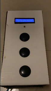

  • Attach the LCD screen on the rectangle hold on the cardboard.
  • Attach the full color LED on the smaller hole.
  • Attach 3 buttons on the 3 bigger holes.
  • Use a tape to stick tighter if necessary.
Step 5: Building - 4
Build a box (length: 26cm, width: 13cm, height: 11cm) with 4 sides using cardboard. Use a hot melt glue to stick the sides together.
Step 6: Building - 5
Put the circuit inside the box. Put the cardboard on top of the box and use tape to stick it together.

How to use it:
  • The top button is to move the alphabet backward & No (for the "do you want to play again" question)
  • The middle button is the start button& confirm button & Yes (for the "do you want to play again" question).
  • The bottom button is to move the alphabet forward
