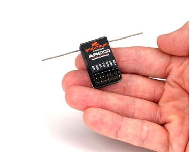

Your radio receiver is going to look something like the picture below.
Normally you will be sourcing the battery power for the flight system from the flight battery and most, (but not all), ESC will have a BEC (battery elimination circuit) so a regulated 5 volts is available for the receiver. This lead will also have the control signal for the EC (Throttle) so will normally go into channel 3 on you receiver. Read the manual and make sure you get the plug the right way round - usually the will go on either way.
There are different "standards" for which channel is used for which operation. In the USA they generally use mode 2, in the UK mode 1 is supposed to be favourite. Personally I use Mode 2 most of the time.
There is no hard rule but keeping to the conventions saves a lot of confusion. On many transmitters you can change the mode of operation.
You will need to plug the servo connectors into the appropriate channel for your use.
Fix the receiver and the ESC down with a small bit of sticky backed velcro to stop them moving around. You can also fix the battery on in the same way.
