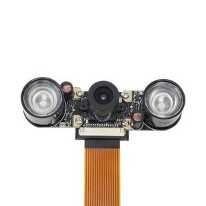

ZeroCam Night Vision
2.1mm M12 CCTV lens without IR filter

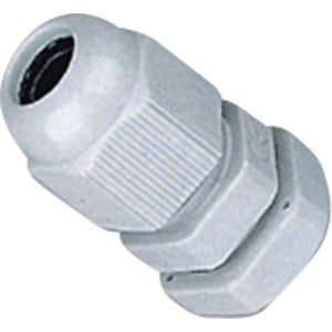

PG7 Cable Gland

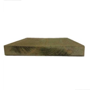

2m 148x19mm wood plank

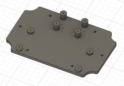

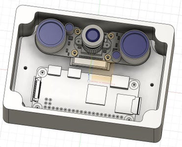

To securely mount the components inside the box I am using a 3D printed a mounting plate. There is an .STL file attached which you can use to 3D print. I use some small 2mm wood screws to mount the camera, IR lights and Raspberry Pi to the mounting plate. (first removing the screws connecting the IR lights to the camera board). You probably have to drill the holes to correct size on the 3D printed part.
The flat cable connecting the camera to the Pi should be included in the camera package. If you buy an alternative camera you might also need to buy the cable that fits the Raspberry Pi nano W. (The full size Raspberry Pi has a wider cable connection socket)

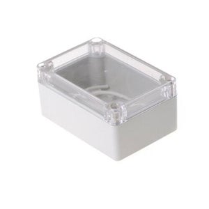

Then drill the hole for the cable gland on the center of one of the long sides of the box. Drill it as high as possible to avoid crashing the inner nut with the Pi. Test fit the mounting plate with the electronics and also the transparent lid before drilling.
Cut of the female plug of the USB cable and remove a few centimeters of the outer shell and shielding. Most likely there are one black and one read wire inside. These should be GND (0v) and +5v. Strip those two and measure the voltage using a multimeter to be 100% sure. Put the cable through the cable gland and solder the red and black cable to the Raspberry Pi pin 4 (red, +5v) and 6 (black, GND)
Then I mount the plate to the box using two 3mm screws and tighten the cable gland. Just leave the lid off now, because we have to put in the SD card, adjust the focus of the lens and intensity of the IR leds.
If you don't have access to a 3D printer you can simply mount the Pi and camera using padded double sided tape. It might be a good idea to make some spacers to raise the camera to get the lens as close as possible to the lid to prevent the side of the box distorting the image.

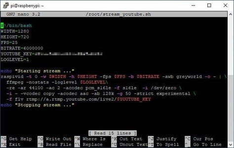

stream_youtube.sh with the following content: (Swap YOUR_STREAMING_KEY with the streaming key from step 2)
#!/bin/bash WIDTH=1280 HEIGHT=720 FPS=25 BITRATE=6000000 YOUTUBE_KEY=YOUR_STREAMING_KEY LOGLEVEL=1 echo "Starting stream ..." raspivid -t 0 -w $WIDTH -h $HEIGHT -fps $FPS -b $BITRATE -awb greyworld -o - | \ ffmpeg -nostats -loglevel $LOGLEVEL\ -re -ar 44100 -ac 2 -acodec pcm_s16le -f s16le -i /dev/zero \ -i - -vcodec copy -acodec aac -ab 128k -g 50 -strict experimental \ -f flv rtmp://a.rtmp.youtube.com/live2/$YOUTUBE_KEY echo "Stopping stream ..."
Note: raspivid has been removed in Rasperry Pi OS from Bullseye onwards. You can use libcamera-vid in stead. The code will look like this:
libcamera-vid -t 0 --width $WIDTH --height $HEIGHT --framerate $FPS --bitrate $BITRATE --inline 1 -o - | \
And stream_youtube.service with this content:
[Unit] Description=YouTube streaming service [Service] User=root WorkingDirectory=/root ExecStart=/root/stream_youtube.sh Restart=always [Install] WantedBy=multi-user.target

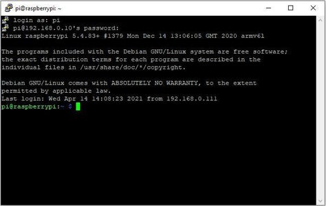

Wait for some minutes for it to boot and find the IP address it has gotten from your WiFi router using the user interface of the WiFi router.
If you are on Windows, download PuTTY
Now open PuTTY on windows and connect to the IP, or use the terminal on mac/linux (ssh pi@[ip address])
The default username is pi and password is raspberry

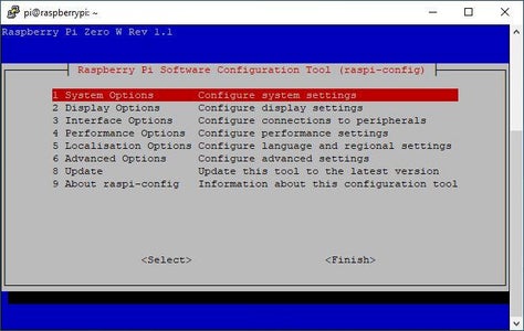

Now we are going to enable the camera and set up how the Pi boots (disabeling graphical user interface)
Type the followingin the terminal/PuTTY window:
sudo raspi-conig
Go to: System options enter Boot / Auto login enter Console enter
Then go to: Interface optionsenterCamera enter Yes enter OK enter
It is recommended to change the password. Go to System options enter Password enter OK enter

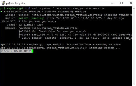

To check if the stream service is started from the console you can use the following command
top
This will show a list of running processes. You should se ffmpeg on top using about 30% CPU
To control the streaming service on the Pi use the following commands:
# Enable the service / make it autostart at next boot systemctl enable stream_youtube.service # Disable the service / make it not autostart at next boot systemctl disble stream_youtube.service # Start the service now systemctl start stream_youtube.service # Stop the service now systemctl stop stream_youtube.service # Check the status of the service systemctl status stream_youtube.service

I have used pressure treated 148x19mm wood which is screwed together.
