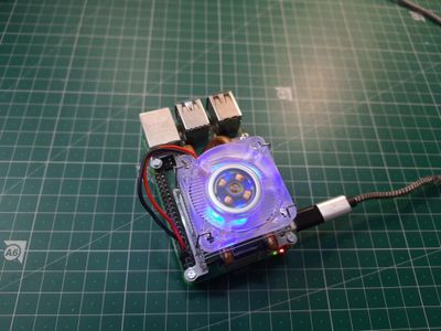

I installed Raspbian system in my Raspberry pi 4 and then I start watching YouTube. I want to make a dedicated review on this. Raspberry pi 4 is known as 4k video player also. My pi 4 is working on 2Ghz, with 650MHz GPU clock. Even it is too much compact but at the price of $130, is raspberry is good option for YouTube.

I have 8GB RAM version and with a decent stock cooler, you can boost the all 4 cores from 1.5GHz(base) to 2.1GHz(turbo). Even there are options to max the Integrated GPU to 700MHz, but mine one is working on 650MHz. I am using 5v 5amp power supply and 32inch TV screen for display output.

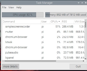

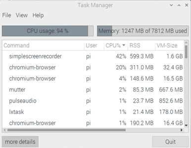

I want to record the performance with screen recorder and I installed one to my system. But once I open the YouTube in chromium tab and start recording. The CPU of Pi 4 has been maxed out. Screen recorder is consuming around 40% of CPU. For an honest review then I start recording externally using mobile camera.

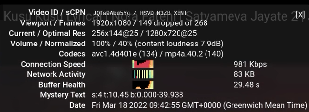

There is about 40-60% CPU consumption, well I am using stock cooler to keep the thermals stable. I found there is some frame initially but after 4-5 seconds of continue playing video, I got a very stable 720p performance at 25FPS and without a single frame drop.

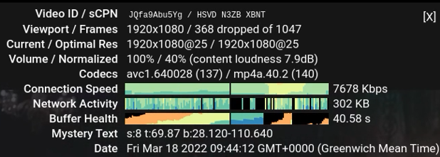

In 1080p the CPU consumption reaches to 70% and running on 38 degrees Celsius. The initial performance remains the same, there are some frame drops. It may be due to internet connection, then we will get a stable video at 1080p@25FPS. I played almost 10-20 videos and the experience remains the same.

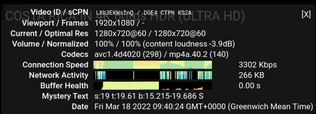

Then I switched to 1080p@60FPS, but Pi 4 can’t handle this. I got a huge frame drop and after 30 seconds it is dropping frames continuously in whole of the video. Really a very bad experience with CPU maxed out to 100%.
