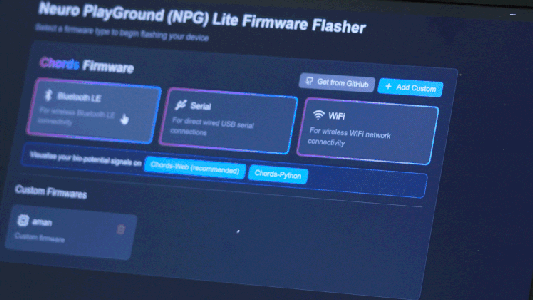

Step 1: Flashing the Firmware
  1. Power On: Toggle the switch on your Neuro Playground Lite to turn it on.
  2. Download Flasher: Download and install the NPG Lite Flasher from the provided GitHub link.
  3. Connect: Connect your NPG Lite to your laptop using a USB-C cable.
  4. Select Firmware: Open the NPG Lite Flasher. Choose BLE firmware from the options.
  5. Identify Port: Identify the correct serial port for your NPG Lite.
  6. Flash: Click the Flash button to begin the firmware upload.
  7. Disconnect: Once the firmware is flashed, unplug the NPG Lite from your laptop.

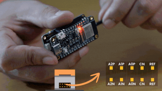

Step 3: Connecting BioAmp Cables
Once your skin is prepared, it’s time to connect BioAmp Snap Cables.
Connect the BioAmp Snap Cables to your NPG Lite .
  1. Channel 1 (EMG): Connect to A0P (positive) and A0N (negative).
  2. Channel 2 (ECG): Connect to A1P (positive) and A1N (negative).
  3. Channel 3 (EEG): Connect to A2P (positive) and A2N (negative).
  4. Reference Cable: Connect one cable to the REF port.

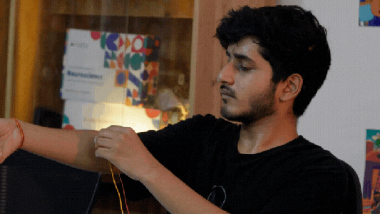

Step 4: Electrode Placement
Channel 1 (EMG): Snap the positive and negative cables to two gel electrodes. Place these electrodes on your flexor carpi radialis muscle (forearm).
Channel 2 (ECG): Snap the negative cable to an electrode on your left wrist and the positive cable to an electrode on your right wrist.
Channel 3 (EEG): Attach the positive cable to an electrode placed on your forehead (between Fp1 and Fp2). Attach the negative cable to an electrode placed on the bony part behind one ear. Place the reference electrode on the bony part behind the other ear.

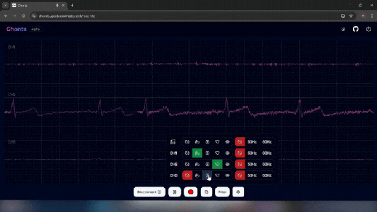

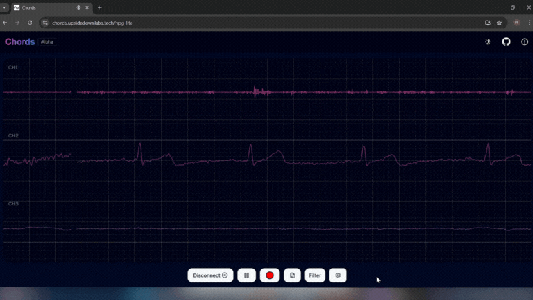

Follow the steps given below to use Chords Web, a web application for recording and visualizing EEG, ECG, EMG or EOG.
  1. Open a Chromium-based browser like Google Chrome, Microsoft Edge, Opera, Brave, etc.
  2. Search chords.upsidedownlabs.tech
  3. Click on "Visualize Now."
  4. Select "NPG-Lite" from the options at the bottom of the screen.
  5. Ensure Bluetooth is enabled on your system (no manual pairing needed).
  6. Click the "Connect" button to scan for available devices.
  7. Select your NPG Lite from the list to begin real-time visualization.
Interface Features: The interface allows you to:
  1. Select which channels to visualize.
  2. Adjust the zoom level.
  3. Play/pause the data stream for analysis.
  4. Apply bandpass filters for EMG, ECG,EOG,EEG, and 50/60 Hz notch filters.
  5. Record data from all channels and save it as a CSV file.
Disconnect: When you're finished, click "Disconnect."
