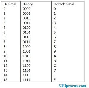

  • The operating principle is simple: Whenever a black color passes over one of the 4 corridors of the sensors, the sensor in the respective area changes its analog output value and the Arduino reads this. Basically, the word will be written in 4 bits on the CD in binary code. Let's take the letter E as an example. In the ACII table in the images it has the hexadecimal value 45. In binary code we have the two characters: 4=0100, that is, on the 4 corridors it will appear in order, on the first corridor nothing, that is 0, on corridor 2 we have 1 and on 3,4 we have 0. This is character 4 in binary code: 0100.
  • Same for 5: first aisle, nothing, that is 0, aisle 2 we have 1, aisle 3 nothing, 0, aisle 4, we have 1. Character 5=0101.
  • 1 corresponds to the area colored in black and 0 has nothing drawn on the CD.
