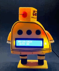

Now that the hardware is wired up, it’s time to bring your Instructables Robot Pal to life with some code. The Arduino Nano acts as the “brain” of the robot—reading the button inputs, controlling the servo for head movement, keeping time with the RTC module, and showing information on the LCD display.
The program includes a few different modes that you can switch between using the buttons:
  1. Clock Mode – Displays the current date and time from the Real-Time Clock module.
  2. Idea Generator Mode – Shows fun random project ideas on the LCD to spark creativity.
  3. Instructables Age Tracker – Calculates and displays how old Instructables is (in years and days) to celebrate the 20th anniversary.
Once the sketch is uploaded, pressing the buttons will cycle through these different modes, letting your robot buddy act as both a desk companion and a creative assistant.

Step 8: Control Central – Buttons, LCD, and Servo!
In this step, you’ll install the robot’s “control center,” including the LCD, buttons, and servo.
Parts Needed:
  1. 3D printed body (from previous step)
  2. 3 tactile push buttons (3)
  3. LCD with I²C (1602)
  4. SG90 micro servo
  5. Super glue
  6. Optional: sand paper and screw (from servo kit)
Assembly Steps:
  1. Install the LCD:
  2. Snap the LCD into the slot on the body.
  3. If it’s a little tight, lightly sand the edges of the slot or LCD holder until it fits snugly.
  4. Insert the buttons:
  5. Place each button into its cutout.
  6. Adjust so they sit straight and flush with the body.
  7. Glue them in place with superglue to ensure you don’t end up pushing the button back from pushing the button.
  8. Install the servo:
  9. Slide the servo into the servo cutout.
  10. Optional: Screw it in using one screw from the servo kit. One screw is enough if you choose to secure it.
  11. No power connection is needed yet; wiring will come later.
✅ Once the buttons, LCD, and servo are in place, you are ready to put on the head!

✅ Once the wiring is correct, the head position and time are set, and everything is neatly bundled, your robot is ready for the final step: closing it up with the back panel.

✅ Your robot is now fully assembled and powered!

Congratulations! By following this guide, you’ve brought your very own Instructables Robot Pal to life. From 3D printing the parts to preparing the wiring, programming the Arduino, and testing everything, you now have a playful, interactive companion for your desk that celebrates 20 years of creativity.
Your robot pal not only keeps track of the time and date but also inspires your next maker project with random ideas and reminds you of the milestone anniversary of Instructables. This project combines electronics, coding, and 3D printing into one fun and functional build, giving you hands-on experience with multiple maker skills.
