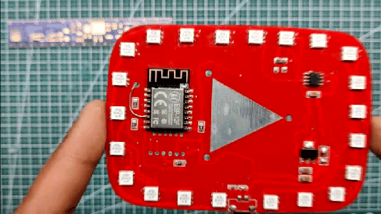

After the schematic is complete, we create the board layout by first searching for a black-and-white image of a YouTube icon on the internet. I then imported this image into the PCB design software and placed all of the LEDs around its perimeter, the ESP12F on one side, and the remaining components on the other.

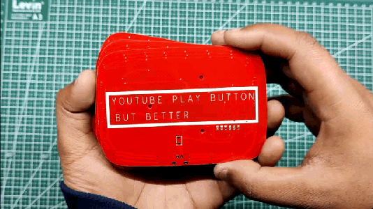

I used PCBWAY PCB Service for this project. I uploaded the Gerber file for this project on PCBWAY's quote page. I used a red Soldermask and a white silkscreen for this YouTube Play Button.
After placing the order, I received the PCBs within a week, and the PCB quality was pretty great. The silkscreen I used is completely random and asymmetrical, so it's pretty hard to make, but they did an awesome job of making this PCB with no errors whatsoever.

  • Board Assembly Process begins by first adding solder paste to each component pad one by one.
  • Next, using a tweezer, we pick and position each SMD component in its designated location. we first begin with adding RGB LEDs and WS2811 IC, then we add ESP12F with AMS1117 setup.
  • Following that, we carefully lifted the entire circuit board and set it down on the SMT Hotplate, which heats the PCB from below up to the solder paste melting temperature. As soon as the PCB reaches that temperature, the solder paste melts, and all the components are connected to their pads.
  • PCB is now fully assembled.
Step 4: Edited Done in PCB

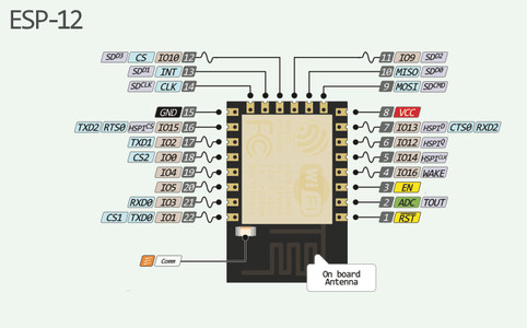

I made a mistake on this board.
It appears that the ESP12F Module only has 12 PWM pins, yet IO15, a pin that isn't a PWM pin, is connected to the WS2811 IC Din Port.
Therefore, I had to remove the track that connects IO15 to the Din Port of the WS2811 and put a jumper between Din Pin and IO14 Pin, a PWM Pin.
