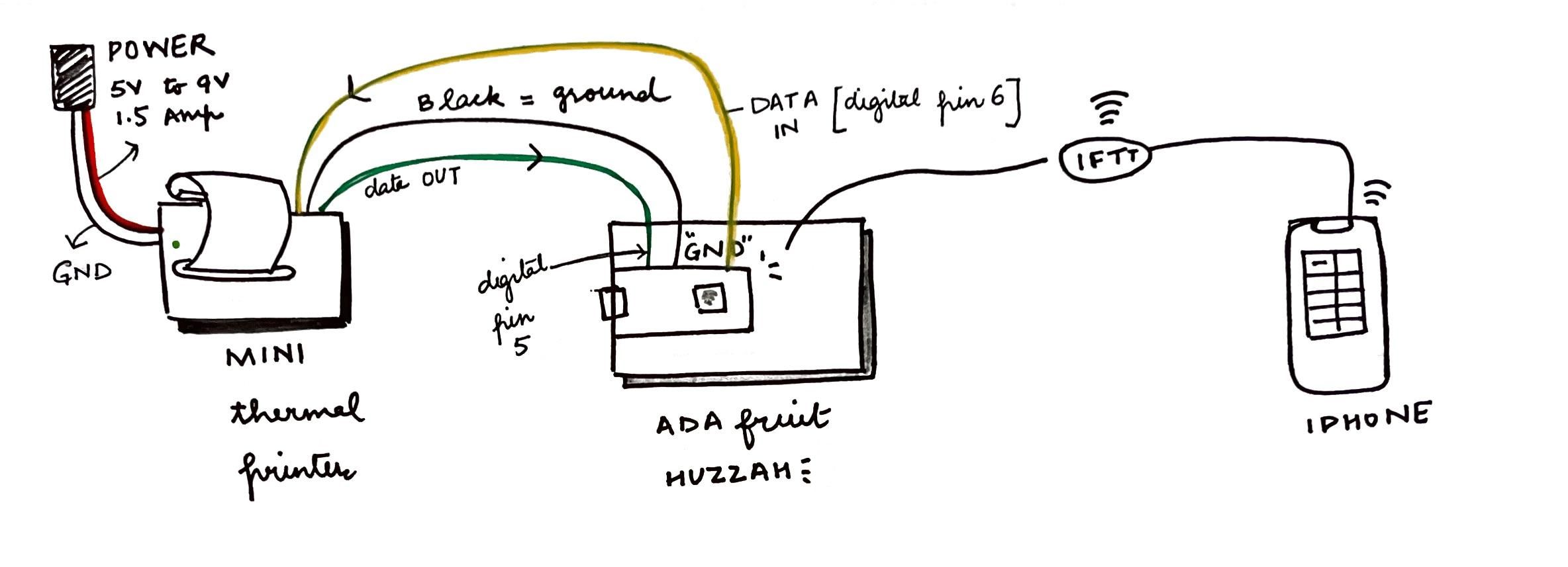

Step 1: Circuit Diagram
  • The Huzzah board is connected to power using the 5V 2.5A with USB power supply.
  • The Mini Printer is powered from the Huzzah board USB pin (Red at USB, Black at GND)
  • The Mini Printer data input/outputs are connected to digital pins 0 and 16 (Green at 0 pin, Yellow at 16 pin, Black at GND)

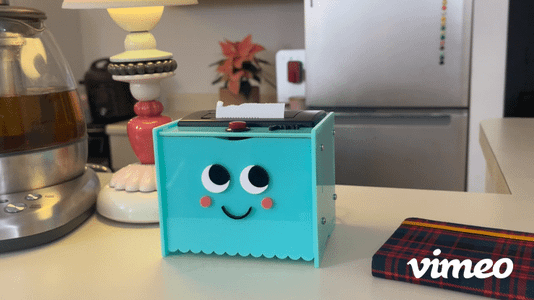

Step 5: Form & Material
For the box enclosure, I used the Adafruit IoT printer as an example. I found the AI file from Phillip Burgess's project on Adafruit. I got a turquoise colored Acryclic sheet for my enclosure. I laser cut the sheet and assembled using screws.
Step 6: Enclosure Assembly
Step 7: Celebrate and Call to Action!
Ta Da!
