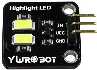

  1. YwRobot High Brightness Lighting LED Module

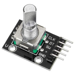

  3. Rotary Encoder module

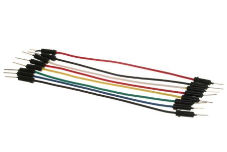

  4. Jumper wires

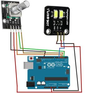

Step 2: The Circuit
Rotary Encoder Module Connections
  1. Connect Encoder pin [CLK] to Arduino pin [2]
  2. Connect Encoder pin [DT] to Arduino pin [3]
  3. Connect Encoder pin [SW] to Arduino pin [4]
  4. Connect Encoder pin [+ (VCC)] to Arduino pin [5V]
  5. Connect Encoder pin [GND] to Arduino pin [GND]
  1. Connect LED module pin [+ (VCC)] to Arduino pin [5V]
  2. Connect LED module pin [GND] to Arduino pin [GND]
  3. Connect LED module pin [IN] to Arduino digital PWM pin [5]

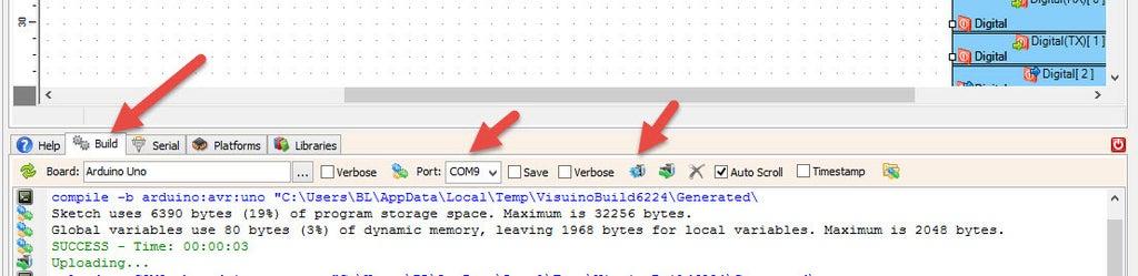

Step 6: Generate, Compile, and Upload the Arduino Code
In Visuino, at the bottom click on the "Build" Tab, make sure the correct port is selected, then click on the "Compile/Build and Upload" button.
