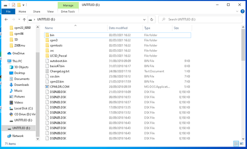

Now we have the software installed it's time to copy the disk definitions file (Step two explains what this file is, but for now just copy it)
Put your SD card into your card reader.
Locate the folder on the SD card called "cpmtools" inside it you will find a file called diskdefs. Copy it to the same directory you created for cpmtools, windows. Or on linux it replace the file /etc/cpmtools/diskdefs, you can do that via the gui/desktop or from a shell prompt with "sudo cp diskdefs /etc/cpmtools/diskdefs"
You can now test your install by trying to get a cp/m directory of a disk image file, below are examples. If you get error messages like unknown format etc - you have not put the diskdefs file in the right place

Step 2: About the Disk Image Files
First a word of warning, if you use the wrong combination of format (the -f) with the disk image to try and copy files to them (not cpmls) it will almost certainly corrupt the image file. So make a copy first! then read twice before you type!
To be able to give you an authentic cp/m machine, the SD card has "disk images" on it, these are single large files that are opened as a disk letter in cp/m. Each file contains it's own cp/m file system and presents to the z80-mbc2 as a physical disk would have done on an original cp/m computer. By doing it like this you get the same facilities the original cp/m machines had and all the programs run without needing to mess around with permissions etc.
The disadvantage is that each image file needs a special program (cpmtools) that understands the disk layout inside the file (diskdefs) So you can't just simply copy a file.
Image files
The Z80-MBC2 maps the disks like A: B: C: etc. into the image files on SD card. With file names like:
DS0N00.DSK or more generically DSxNyy.DSK;
The file name has this naming convection to make it easy for the IOS (and users) to map the version of cp/m and the drive letter to use, like this:
DSxNyy.DSK
x = from 0 to 9 is the OS:
0 = CP/M 2.2
1 = QP/M 2.71
2 = CP/M 3
(the other os's like UCSD pascal etc use a different image name, not relevant to cp/m)
yy = the cp/m disk drive letter:
00 = A:
01 = B:
02 = C: and so on up to 15 drive P:
So if you boot into CP/M 3 and are logged on to drive B: you would be accessing the SD card image file called DS2N01.DSK
