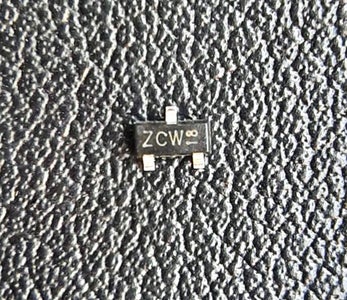

PNP low VCEsat transistor in a small SOT23 (TO-236AB) Surface-Mounted Device (SMD) plastic package. NPN complement: PBSS4350T.
plastic, surface-mounted package; 3 terminals; 1.9 mm pitch; 2.9 mm x 1.3 mm x 1 mm body

  • Type number: PBSS5350T
  • Marking code: ZDW

Step 1:
ZDW Transistor Pinout :
