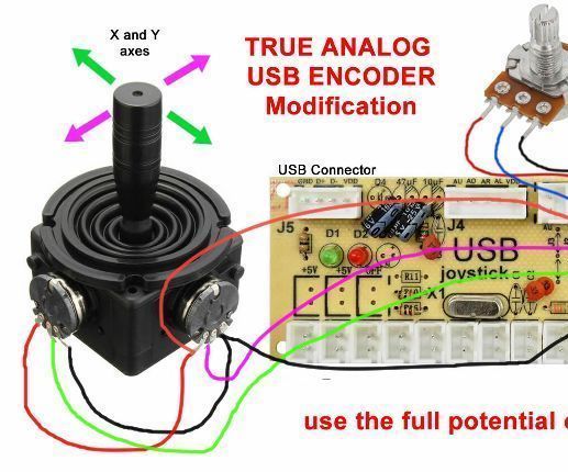

Introduction: ZERO DELAY USB JOYSTICK - AUTO ANALOGUE MODIFICATION
This is an additional project to the Zero Delay USB Encoder True Analog Joystick Modification.
You need to have successfully modified, tested and calibrated the Encoder in the previous project before adding this device.
When completed and working it takes away the annoying feature of the modules habit of always starting up in Digital mode - which means you need to select Analog using the mode switch every time you want to use it.
UPDATE: (feb 2021) Before you get stuck in to making this - I updated the main project in Feb 2021 to say theres an easier modification than this little gizmo... but if you really want to make it heres the info..... Enjoy
What this project does is to mimic you pressing the mode button ONCE to get it to Analog mode - using a time delay (resistors and capacitor) to operate a transistor as a momentary switch.
The sequence only starts once USB connectivity is established with the computer - by taking the +5v supply (approx) which feeds the RED Led (Digital On) and using that to start the timing which is just the charging of C1.
Once the transistor is switched on the Encoder see's that as a single MODE switch action and it switches to Analog.
Once in Analog mode the RED Led goes off - turning off the Timer circuit and the GREEN Led turns on and the Encoder works in Analog mode ! (Simples!).
Its important to note that if USB connectivity with the PC isn't established - it won't start the Encoder or the timer!
So just testing the Encoder on a 5V USB supply (no PC) isn't going to work !
I added a reset button just to prove I could manually restart it without having to unplug the USB every time.

Step 3: The Schematic Diagram and Encoder Connections (with Options)
The diagram shows in the Green box the new circuitry (on your new board) and in Yellow the Encoder module connections that are relevant here. You don't have to understand it - just wire it all up correctly - and remember - no further tracks to cut on the Encoder.
On the Encoder:
A = Junction of the +5 volt feed from the Encoder chip (Black blob) to R10 which feeds the RED Led. The end of R10 nearest the Blob is the one to use.
Note the wiring supplied by the Chinese makers which plugs into the Encoder Mode socket appears to use RED for ground (0v) and Black for switching - so don't assume colours are logical - Check for yourself !
B = Mode switch input connection.
C = 0 Volts - (and second Mode switch connection)
