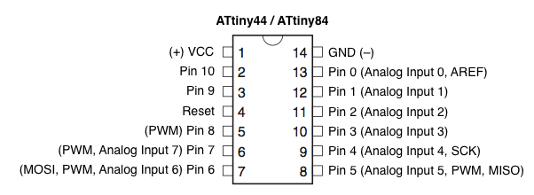

Second, always keep track of where pin 1 is on the picture and on the board. Spin the pictures around to keep them orientated with the board as you work.
Third, remember that the ZIF socket is numbered differently -- the pins go counterclockwise around, so 8 is opposite 1, and 5 is opposite 4. The ATtiny13 and ATtiny85 have similar pinouts, so both will work in the jig.

The same six signals appear on all headers and the ZIF socket.
Pick one, grab the assigned wire color, and daisy chain up the headers and ZIF socket. If you didn't write down the color you chose on all the pins on all the diagrams, do it now. Saves tears later.
Repeat for the other 5 signals.
1. Keep the diagram and board oriented with each other while you work.
2. Pin one is always on the corner nearest the green power LED.
3. Treat the ZIF socket holding the chip as being numbered the same as the chip that will be inserted into it. For ATtiny, pins 1 to 8 go counterclockwise so pin 5 is opposite pin 4, and 8 is opposite 1.
4. Don't confuse MISO on 6-pin header pin 1 with MOSI on 10-pin header pin 1.
