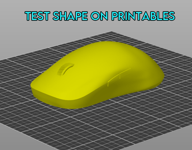

This is based on the Sensei. There doesn’t seem to be a wireless one. If you’d like to try the shape first then check it out on Printables:
https://www.printables.com/model/474276-test-shape-zs-a1-mouse-mod-shape-test-sensei-based

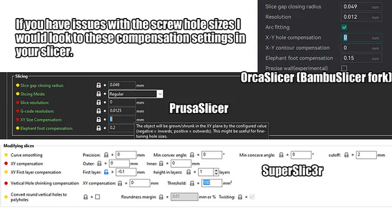

I’ve printed my drafts and test mice with Arachne perimeter generation since it’s frequently the default now. If you have issues with them you could try classic, but I would look to the XY / hole compensation settings.

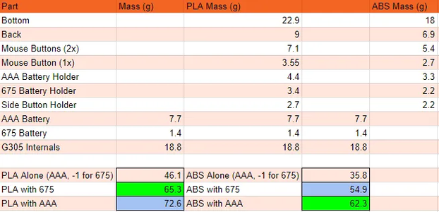

It wouldn’t necessarily change that much, but I didn’t design this to be as light as possible from the get go. As a result, I consider it between “aggressively-fine” to “a bit of a chonk” weight-wise. I expect most people to print it in PLA and use a AAA battery (rechargeable or not), but also have a battery holder for a 675 button cell battery option. I’ve also printed this in ABS which is another option to save a few grams as long as you’ve got adequate filtration. Below is a chart with all of the mass info and combinations.

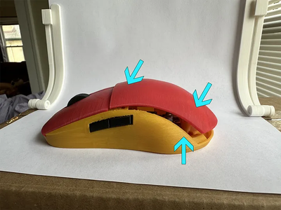

Not all of my prints are perfect. Here’s an example from my Prusa Mini. The two mouse buttons printed slightly differently causing them to sit unevenly. I’ve since reprinted them. You can also sand or file down the corners if it’s obviously not flat/square in the area you screw down into place.

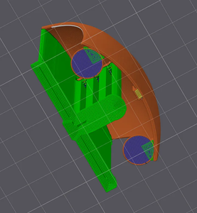

Step 4: More Print Advice (Supports)
It’s a bit of a heartbreaker but.. I do recommend using supports. I know, I know, big sad. Of course I’ll provide some images of how I’ve sliced them along with 3MFs that have painted on supports, but the specifics of your support settings will be case-by-case. I’m partial to Snug supports with a 0.24–0.25mm top layer distance for example, but have found that Tree/Organics are also pretty useful, especially for the Bottom piece with the big middle overhang. That being said, due to.. questionable workflow.. I’ve done a ton of draft prints without any support on that part. It’s doable, but it isn’t particularly pretty. And remember ALWAYS wear eye protection when removing supports. The plastic is wild, and you never know what it’s gonna do.

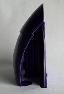

Step 6: More Print Advice (Back Piece)
The Back can be a more challenging to print than you’d expect since it has such little contact area with the build plate. I’d print it slowly and add a brim or at least ears on the underside of it.
Here's an example of printing too quickly even with brim ears.

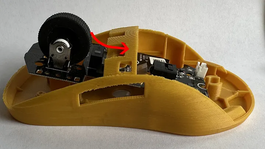

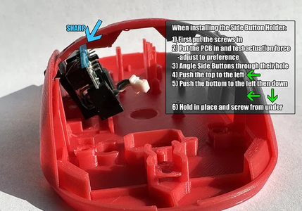

Step 8: Slotting the Side PCB + Piece Into Place
(The Bottom piece shown here is slightly outdated. There are less columns on the final version)
For the Side Button PCB Holder use gloves or something when screwing it into the bottom. I know that probably sounds silly, but you need to push down and hold it in place once the Side Button PCB is in there, and it’s sharp. Trust me on this.

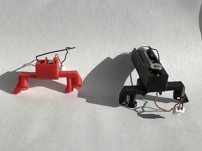

The main thing is to make sure the On / Off switch doesn’t fall off during this. They’re really finnicky. The Side Buttons should be installed, but I’ve removed them so it’s slightly easier to see.

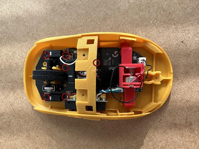

Step 11: Assembling the Rest
The screw under the bridge is annoying to get. Technically you don’t need to use it, but I would.
Use two long screws to secure the Mouse Buttons. I designed a bit of slack into them so that you can move them slightly in all directions in case your print isn’t perfect in the squared area. If you overtighten these your mouse buttons will likely raise more than you want in the front area.
For the Back piece snap the front into place first, then align the back column before flipping it over and screw it into place.

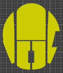

I understand that not everyone likes the texture of 3D Printed Mice, as such I’ve included grip templates so you can cut some from a roll. I would probably cut some of them down, as they’re flat projections of curved surfaces, but how much you use is all preference.
