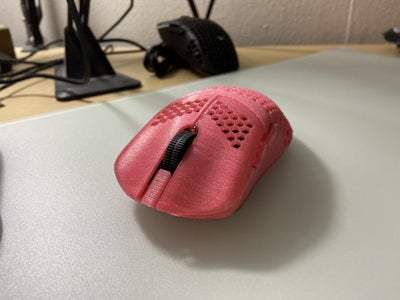

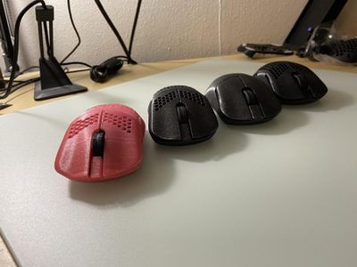

Introduction: ZS-F1, F-2, Wireless 3D Printed Finalmouse Ultralight 2 Guide
This mod uses the Logitech G305 PCB. Here are some renders, measurements, and examples of prints.
The ZS-F2 is just a medium sized version of this mouse and all steps are the same.

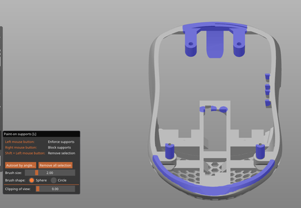

Here are the printing orientations I use. I've printed this on an Ender 3 and Prusa Mini in PLA. My slicers are Superslic3r and PrusaSlicer. I stick close to the provided 0.2mm profiles, with minor tweaks for my particular printers and filaments. In these examples I have ticked "Print Thin Walls" and "Avoid Crossing Perimeters". Use your best judgment when printing.
I print the top piece at a 45 degree angle. You can also use "Place on Face" and the flat spot at the back.
I manually paint supports mainly, but I'm sure you can use the auto-generated ones.
The really small pieces come in four sizes, but you can probably scale their height to whatever works for you if you really want to dial in the clicks.

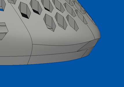

The back isn't flush by design. I am aware that it looks sort of weird, but it was too difficult to pry open before I changed it like this. The flat spot also serves as the initial contact point for the printing bed.
