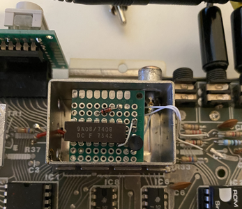

Step 2: Video Out Issue
The original TV modulator was not functioning, and I didn’t have any TV's that would work anyway, so I added the ‘back-porch’ circuit for a more standard video output that I could use with a regular monitor. (See http://www.fruitcake.plus.com/Sinclair/ZX80/VideoGeneration/ZX80_BackPorchGeneration.htm for a good explanation of the need for this circuit).
There were several different circuits that I looked at, but I liked this one (and I had a 7408 in my old parts drawer..). I did add a 1K resistor to ground at the base of the driver transistor. This moves the signal level slightly and is closer to standard video. I built it and put it inside the modulator box.

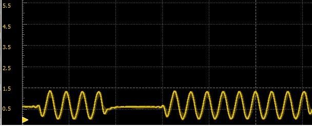

After getting the hardware working I kept having a LOT of problems with loading software. I had just a couple .wav files to try and they failed nearly all the time.
Most programs are saved as bit images in .o or .p files. I found a program to convert the file to audio, or to create a .wav file from the image file, for output from a PC to the ZX80 cassette input. The output from my test laptop or my basic USB audio adapter plugged into my test laptop, was not nearly enough to drive the cassette input. Looking at the circuit and tracing components on the ZX80 told me why. Not sufficient drive to the 74LS365 (IC10) in the ZX80 to receive any data. The 74LS365 needs at least 2.0V for a guaranteed high input with a 5V supply. I am getting less than 1.5V (see image). This is too low. I wondered about that.

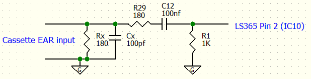

Step 6: Cassette Input Circuit
Most of the ZX80 schematics I found look like this circuit, with just 47nF coupling capacitor and a 1KΩ to ground.
Step 7: My ZX80 Input
This circuit is what mine looked like (with some additional components added by the manufacturer). The addition of the 180Ω resistor and 100pf cap were added to give a lower input impedance and to provide a little filtering for tape recorder/player outputs. That meant that the drive to this circuit would need to develop over 2V across the input resistor (180Ω ) to give an input large enough for the 74LS365 (IC10) to receive reliably. I needed at a minimum a small power amplifier to hook to the output of the laptop or USB adapter, or another approach.

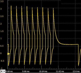

Step 11: Output From Driver
This is a pretty basic circuit, but it will generate a very reliable signal at the cassette input. The image shows what the input to the 74LS365 looks like with this circuit driving the cassette input. (This is a binary 1 signal set).

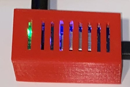

Step 18: Small Case
I put the hardware in a small 3D printed case. I included the file for the case that I used.

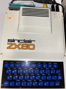

Step 19: The Whole System and Conclusion
Some images of the ZX80 with the ESP8266 hardware. The whole system running the MAZOG game.
With the ZX80 fully functioning and having the ability to load a program using a browser to select the file makes this approach nicely versatile and dependable. It still takes a while to load up files that are pushing 16K, but that is how it has always been with this beast. I am pleased with how this all came together.
