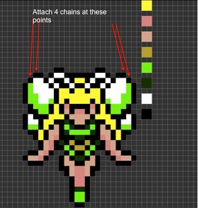

So I decided to design a necklace to show my love of a game, that I did eventually play seriously, but I'll always get the warm fuzzies when I see the fairies. So this elegant necklace is made by bead weaving, specifically the flat square stitch. Then just simply attaching a chain the correct places. Now I have discovered that there are no flat square stitch instructables, so let's fix that.

Alright so I like working with 11/0 beads, but they are tiny and other options due exist! This is a list of exactly what I used, not what you are required to.
1. Yellow Beads
2. Purple Beads
3. Light Purple Beads
4. Dark Green Beads
5. Light Green Beads
6. Red Beads
7. Silver/white beads
8. Light Peach Beads
9. Dark Peach Beads
10. Gold Beads
11. Black Beads
12. Needles
13. Thread
14. Silver Chain at least 2 feet.
15. Clasps of your choice
16. Large bead for a stopper
17. Patterns, above.
