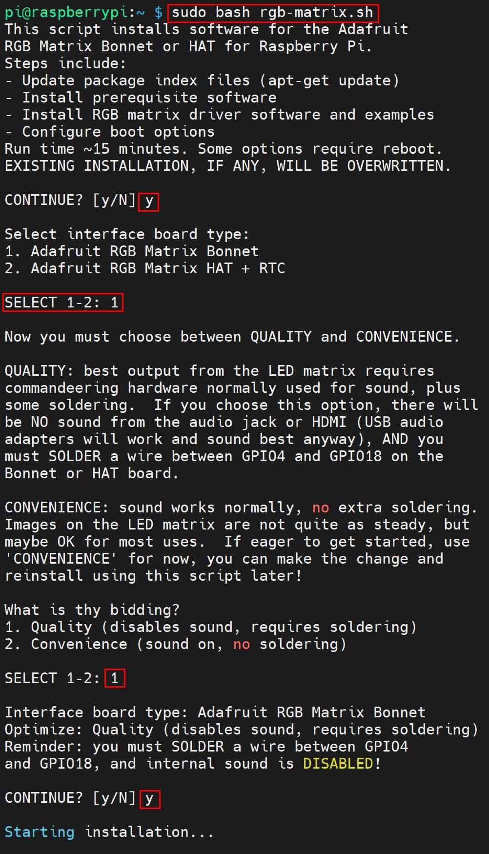

Downloading and compiling the mirroring the software
You can find a link to the more detailed guide on Adafruit's website HERE & HERE
cd ~
curl https://raw.githubusercontent.com/adafruit/Raspberry-Pi-Installer-Scripts/master/rgb-matrix.sh >rgb-matrix.sh
sudo bash rgb-matrix.sh
Follow the setup by selecting either between the HAT or the Bonnet. Just make sure you select the quality option since we soldered those two pins together earlier. After this is complete, select reboot.
This next part installs the desktop mirroring software.
