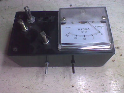

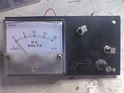

To operate this checker is very simple. You put the Zener on the checking lugs that have the magnets. Hook up the power on the back lugs. Turn on the power to the back lugs. Turn sw on on the checker. Adjust pot to get the highest voltage on the meter. That is your Zener voltage.

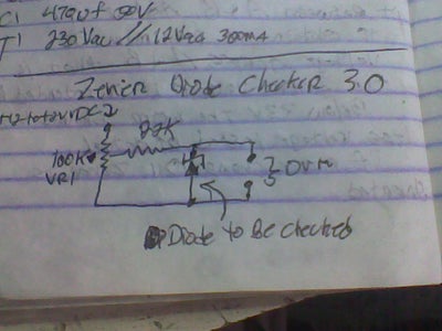

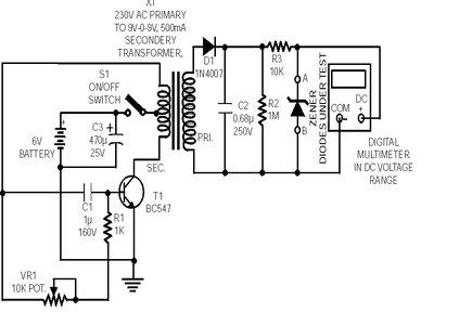

Step 1: The Schematic
The schematic i ended up using wasn't the first one i tried and i didnt pick it because it was the simplest. It is the one that worked the best for me in the end.
I think the first checker was affected by the charging and discharging of the cap. Made it difficult to get a steady readout. I am not really sure but it was hard for me to use.

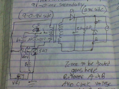

The hand drawn schematics are just from my reference book that i use. They are the same as the previous 2 schematics.

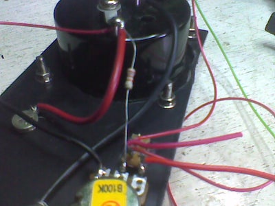

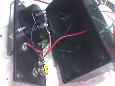

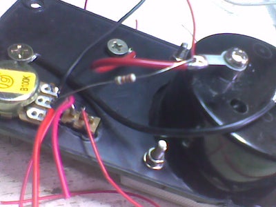

There is some extra wires left here from the first build that have not been removed yet.
I soldered the 22K resistor from the wiper on the pot to the pos line as per the diagram. One end of the pot i will call the neg post goes to the neg line. It was easiest to attach at the volt meter, as was the pos but on the pos line. Neg from the meter went to the gnd post on the outside power connection. The other end of the pot i will call the pos lug goes to the pos post also on the outside power connection.
You can see all the extra wires have been removed and the wiring has been cleaned up.

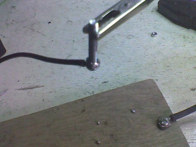

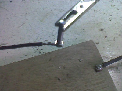

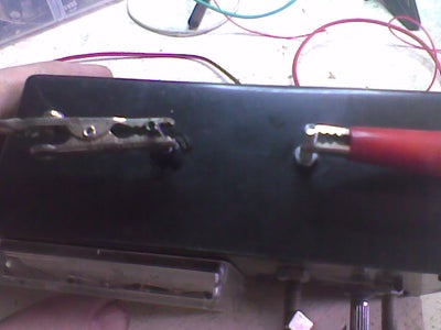

For the 12v dc power lugs, I started by soldering the leed on the lug then bend it around just under the head and finish by soldering it complete. All the way around.

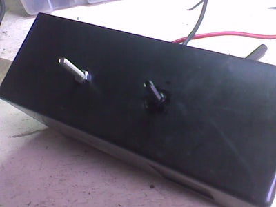

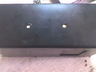

I choose a location that was as out of the way as possible yet convenient to attach the 12vdc power. I choose the back of the box. Marked the holes, drilled 1/8 holes. Attached the lugs with the soldered wires attached from inside out and secured with a nut. I used a black felt pen and colored the neg black and left the pos natural color.
The power source comes from my power supply 12v dc. Just hook it up with alligator clips.

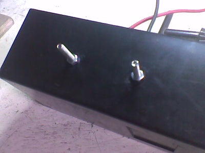

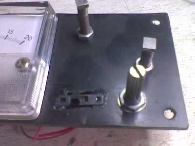

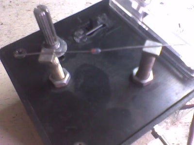

Previously i had installed several components.The test lugs, I added small magnets at the top to attach the Zener to for ease of checking. The 100k pot, switch and the volt meter.

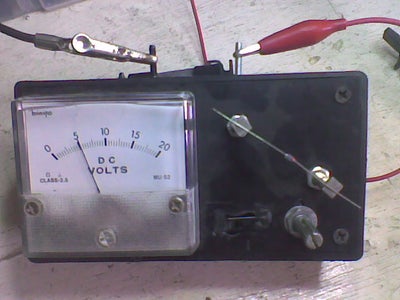

If you attach the Zener backwards it will read just above 0.

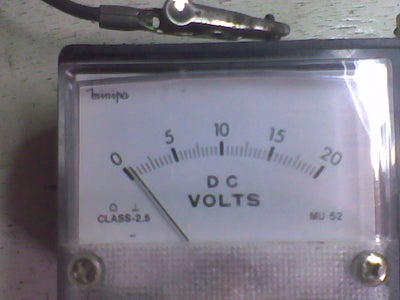

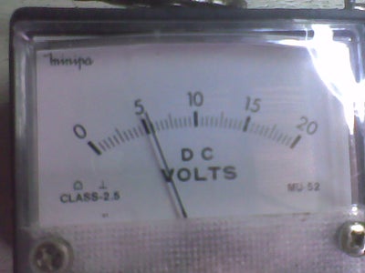

This is 6.2v Zener i am testing. You see it shows around 6v. An analog gauge may not be as accurate a digital read out.. An analog readout has some room for interpretation due to viewed angle ect, but it can get you close.
I have noticed on lower voltage Zeners such as 2.8 volts the reading is lower that the rated voltage. Even with that incorrect lower voltage it is still better that not knowing what the voltage it is.
