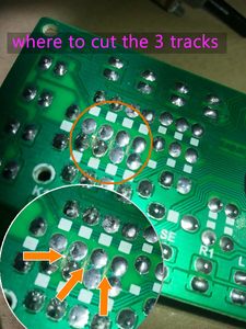

Step 3: Resistors and Tracks
So from experimentation I have discovered that this "balance" is achieved by the presence of the 2 x 10K ohm resistors.
The Balance resistors are in effect a fixed 20K potentiometer (10K + 10K) - in its central position. They are wired in series between the +5V and Zero volts pin of the USB connection from the PC. At the junction of the 2 resistors the voltage will be 2.5 Volts.
The manufacturers save money on the resistors by linking them all together. - all of the junctions of R1+R2, R3+R4, R5+R6, R7+R8 are all linked together on the rear of the PCB by very fine tracks.
Now, the quick and dirty point of this Instructable is that to make the "Analogue" part of this encoder do its stuff, you need to unsolder and remove these Balance resistors and replace with linear potentiometers and carefully cut the appropriate tracks between the pairs with a fine blade.
There are 3 links in total.
If you don't you won't have independent controls.
ONLY CUT THE TRACKS BETWEEN THE CENTRAL SOLDER PAD PAIRS WHERE THE RESISTORS WOULD HAVE BEEN ! Any other tracks go to the chip hidden under the Black Blob - and you DO NOT want to cut those.
With experimentation I have successfully added 4 linear potentiometers (in my testing 2 x 100K for X+Y axes, a 20K for Rudder control and a 300K slider for Throttle) to fly in FSX.
The values don't appear to be critical but linear potentiometers will always work best for this type of activity.
I just tested with what I had to hand - an old Maplin joystick in a plastic box with 2 push switches, a simple potentiometer and a slider control on a pcb which used to be the temperature selector out of an old kettle base unit. No such thing as scrap - just parts waiting for a new project !
Don't just cut the tracks, fit potentiometers and expect it to work in Windows - its unlikely to work correctly UNLESS you run the calibration program. Windows has to understand what you fitted and the ranges these components provide at their full ranges.

If you only want to use some but not all 4 channels then you need to make sure the unused ones still have balance resistors fitted otherwise if your game or other software is looking at the values it could have a negative effect on the desired effect. Without any resistors you will see the values dither about in the calibration program.
If you separated all the channels by cutting the tracks but want some to stay as they were you can just fit new pairs of 10K resistors in the appropriate holes after cutting the tracks.
If you happen to wire the ends of the potentiometers the wrong way round you may be able to invert the control function in the game you are playing to save rewiring if the game allows it - otherwise switch them round !
The wiper (centre) of the potentiometer must always go to what was the centre junction of the balance resistors.
Then either end of the potentiometers are wired to +5 v and 0 v respectively.
Mostly I just soldered the wires to the rear of the PCB. You need to be careful and tidy here - but its your design so careful planning is time well spent !
One VERY important thing to note is that with the encoders, the Common track running around the edge of PCB is NOT zero (0) Volts - its the +5 volts USB supply from your computer - so you don't want to be connecting it to Ground in any constructions you might be dreaming up !!

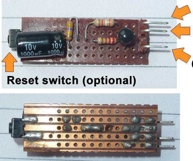

UPDATE::: Feb 2021 ******
Modification to Start in Analogue Mode:
I have been advised by other users (they deserve the credit! ) that if you change the position of the Resistor at position J1 to the upper location instead of how it was supplied (digital mode) the module will automatically start in Analogue mode - so you dont need to construct my fancy solution (link below). You probably wont ever need a mode switch either - the choice is yours.
I have done that modification myself and it works - so thanks to all who reported it!
If however you insist that you want to make something which will mimic you pressing the Mode button once after a short delay then the link is below.
This is the link:
https://www.instructables.com/id/ZERO-USB-JOYSTICK...
This modifcation pcb could have uses for other projects or functions on this pcb for the adventurous amongst you. Please note that not all of these switch options - Auto / Turbo / Mode etc function the same. From memory I think some switch high and some switch low. Always check with a voltmeter to understand its actions.
