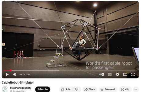

Much work has been done on linear actuator and cable-based robots. Examples include delta 3d printers, string suspension robots, suspended electromagnets, suspended sports cameras, etc. Due to that, the kinematics are already well-established.
Applied to space simulation, two basic lessons are available, presenting the idea of moving a ship through a 3D space using strings and adding continuous, individually driven servos for movement. In research contexts, full 6-string systems are used for spacecraft dynamic validation and integrated with other components such as load cells and IMUs.
References available here:
  1. Motion idea with 3 hand driven strings.
  2. 3 Continous servo driven strings. No kinematics.
  3. Research Project topic
  4. Research paper on similar work
  5. Full scale, 1 passenger system for simulation.
However, on hobby level, few projects have attempted to simulate motion through space using a string actuator. I aim to address this.

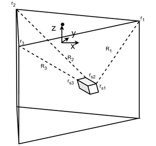

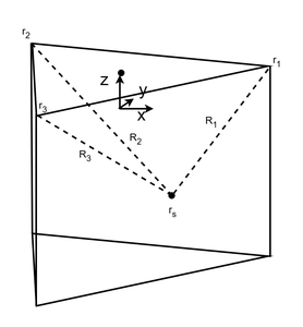

Step 2: The Kinematics
Kinematics is the math describing the relationship between the controlled geometric quantities (string length) and the resultant position and orientation of the object being controlled. For this project, we only require forward kinematics, which is based on the Pythagorean theorem. Other examples which require kinematics are 5-axis CNC machines and robot arms.
We place the base coordinate system (See diagram) some distance below the centre of the horizontal triangle formed by the three eye hooks. The coordinates of each eye hook in the base coordinate system is known from the CAD design.
In the simplest case, we assume all strings end at the same point on the ship. We therefore model the ship as a point mass. We use the Pythagorean theorem (See equations) to get the distance between the ship point and each eye hook point. This corresponds to the length of string required for that position. This can be used to place the ship anywhere within the triangular space.
However, in practice, the string lengths are only valid if the strings remain taught. This is important to preserve the illusion of smooth movement through space and adds several conditions:
  1. We should remain within the triangular area. This can be done with a position check.
  2. Downward acceleration must be kept below g to keep the strings straight.
  3. Abrupt changes in movement speed must be prevented or else the system will bounce around on the strings.

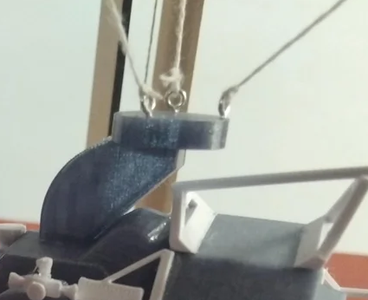

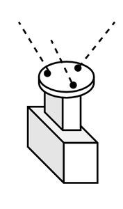

Once the above concepts are properly implemented, we generalise the system to an extended object (See the second diagram). This is the case if we wish to attach the strings to arbitrary points on the hanging ship and control both its position and orientation. The orientation is important since the ship must be axis-aligned during the docking procedure.
Unfortunately, this is mathematically impossible.
We could calculate the resulting position and orientation given any set of string lengths. This involves the 3 kinematic constraints and the 6 equations (3 force and 3 moment) for static equilibrium. Then the unknowns would be the position and orientation (6 parameters) and the tension in each string (3 parameters). This comes down to a well-posed set of 9 nonlinear equations in 9 unknowns.
But even if we solved this successfully, we would still only be able to command a 3-dimensional subspace in the full 6-dimensional position and orientation space. In general, an arbitrary position and orientation in the 6D space is unlikely to be achievable. Intuitively, even if you held the hanging ship in an arbitrary position using your hand and tightened all the strings, once you released it, it would still swing away to some other equilibrium position and orientation due to gravity.
We could overpower the equilibrium equations by adding another three steppers and strings and reducing it to only the kinematic problem, but that requires significant additional hardware and complexity.
Instead, we try and cheat.
It is sufficient to always keep pitch, roll and yaw at zero or at least when it is near the docking point. During the implementation of the point mass kinematics (see photo), we notice that the centre of gravity (CG) is some distance below the attachment point of the strings. This ensures that the prong remains vertical (pitch, roll = 0). Additionally, due to the fact that the strings are not exactly attached to the same point, the yaw orientation seems fixed, independent of the position. Despite technically being an extended body, the prong's orientation remains fixed!
The pitch and roll remain stable since the mass acts like a pendulum. The total tension is approximated as a resultant force co-linear with the gravity vector. Any tilt causes these to be misaligned, and a moment is created that re-aligns them.
For yaw, typically, the tension forces meet at the geometric centre. If the attachment points are slightly apart, twist will change the direction of the forces, which leads to a restorative moment acting to keep the yaw stable.
The above can be applied to the full extended body (see diagram) as well. We only need to add an attachment which allows all the strings to be attached at nearly the same position vertically above the CG. The distance between individual attachment points and the distance to the CG must be chosen appropriately. It results in a trade-off between time for yaw to settle and tilt error as a function of position.
Additionally, it is difficult to align such an attachment correctly when added to an existing object (see the second image). Therefore, it is wise to add a large number of pilot holes for fine-tuning the resultant equilibrium orientation.

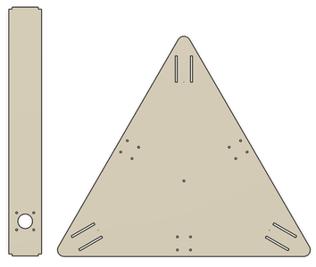

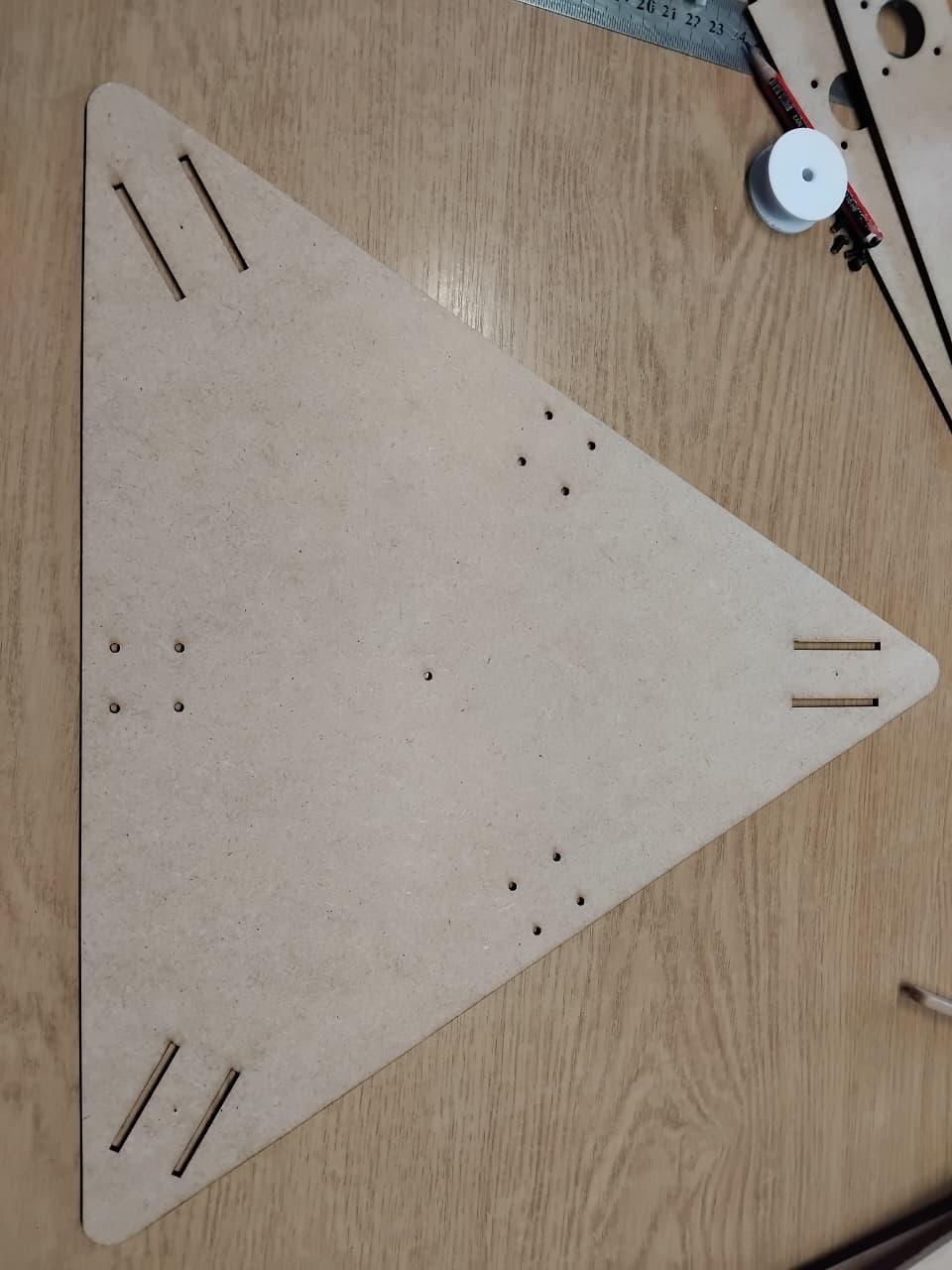

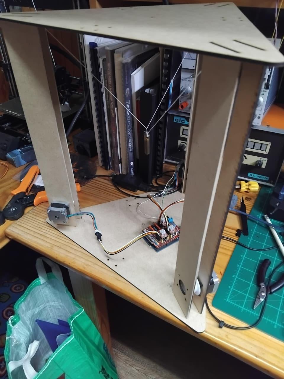

Step 3: Design of the Frame

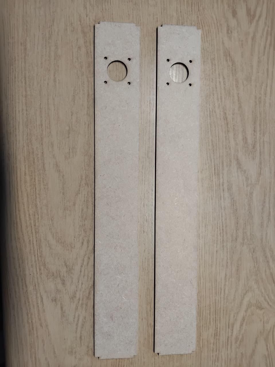

The frame is designed in Fusion 360. No strict conditions need to be met, but it must allow stable mounting of the stepper motors at known positions and be rigid enough to remain reasonably still if the ship moves. Otherwise, components are designed to be as large as possible while still fitting in the 400x400mm MDF sheets that fit on our laser-cutter.
The design consists of two triangular plates and 6 vertical bars to hold them together. The plates contain two parallel slots for each bar pair. A central hole is cut for accurate calibration. (With CNC machines, accuracy will never be as good as the first time on the machine bed. Therefore, try to think ahead for all possible fixture requirements.) More holes are cut at known locations to allow mounting the fixed ship and any additional features. Additionally, pilot holes are lasered to accurately place the eyehooks.
The steppers will be mounted on the vertical bars. The bars contain a large hole for the stepper body to fit in and smaller mounting holes for the bolts.
All the bars and plates are identical and symmetrical to avoid the need to keep track of which part goes where.
I opted not to add tolerance space and rather post-process and use a hammer to get everything to fit. You will need a pretuned cut profile (with kerf offset) for 4mm MDF prior to attempting to cut the parts.
Side note about method to create designs for Laser-cutting in Fusion 360:
Laser cutters require closed loops in vector drawings to cut the required shapes and to apply corrections (kerf offset). Fusion 360 sketches don't usually have this requirement and tend to have many open or crossing lines. The easiest way to fix this is to draw your shapes (with all desired construction lines) in a sketch, extrude the desired geometry by 1mm, create a new sketch on top of the extrusion and project the extrusion body to the new sketch. The created 2d geometries are guaranteed to only contain closed loops and can be directly imported into LightBurn for Laser cutting as DXF files.
The design file for the frame is attached.

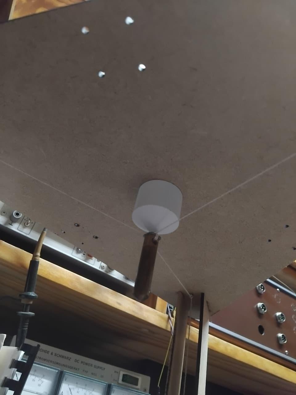

Step 4: Wiring the Arduino and Steppers
The project requires the control of motors to shorten and lengthen the strings.
Stepper motors were chosen for this project because they are ideally suited for many rotations of accurate position-controlled movement. In contrast, position-controlled servos are limited to only a single rotation or less, while continuous servos have no accurate way of going to a specific position without an encoder.
For convenience, a GRBL CNC shield (very cheap) for Arduino Uno is used. It allows immediate connection with stepper controllers and connectors for the motors. The motors are connected to the CNC shield using standard 4-wire cable and an additional custom connection cable. The u-step selection pins were pulled high with a piece of bare wire.
The stepper motors are mounted to the frame using standard M3 bolts.
A pulley is 3d printed and attached to each shaft to wind and unwind the strings. The strings are cut to longer lengths than that of the frame, attached to the pulleys, fed through the eye hook and attached to the controlled object.

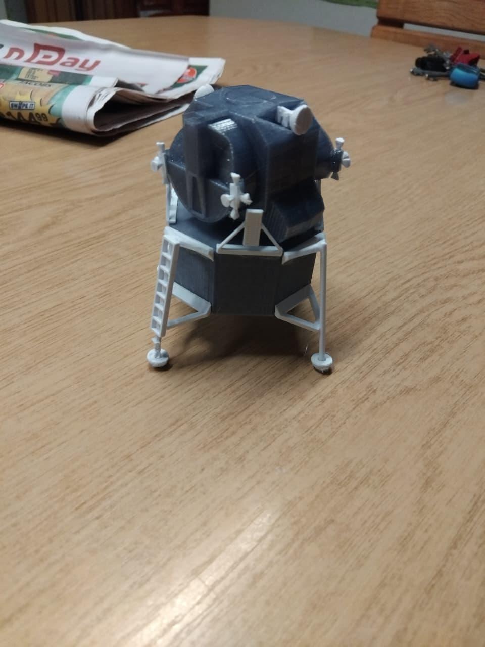

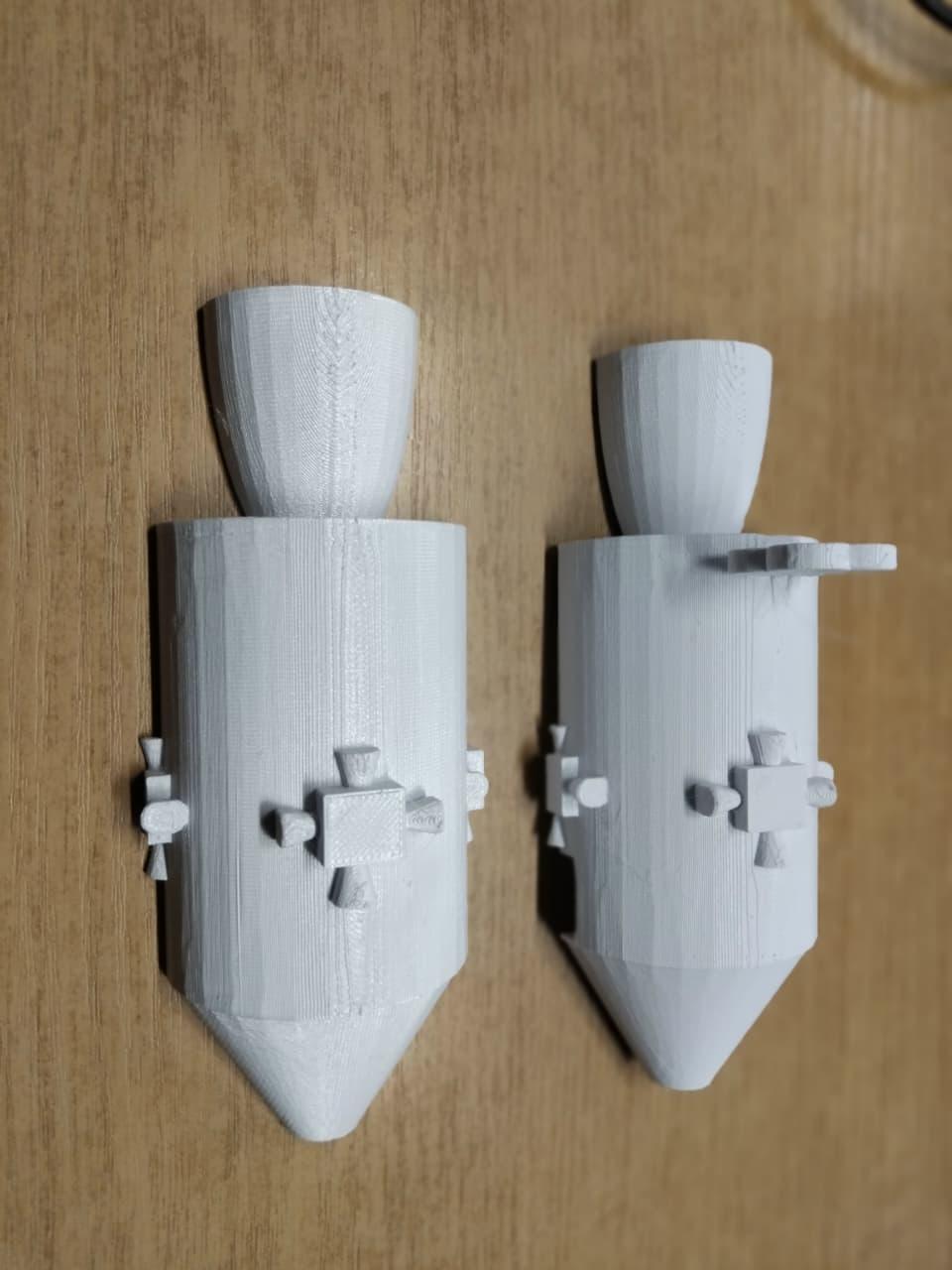

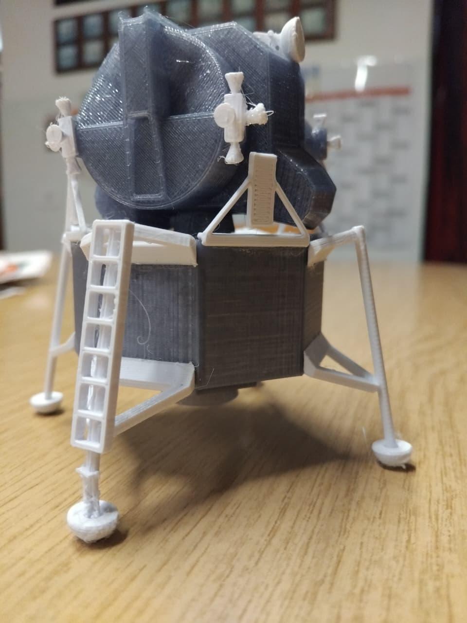

Step 7: 3D Printed Model of Space Ship Pair
For theatrical effect, I required a pair of spaceships to dock. Options range from the times of the space age (Apollo-Soyuz Test Project (1975)) to modern commercial systems (SpaceX Crew & Cargo Dragon Dockings). I chose the docking between the lunar lander and the command module of the Apollo 11 mission to recreate a well-known historical event. A model pair (found here, created by Cindy Jory) suitable for docking was available from Thingiverse.
The original ship pair (good image here) was largely coloured in a combination of metallic silver, black, and yellow. As I don't have access to filament matching those colours, I decided to take artistic liberty and simply try to emphasise detail rather than being accurate. The model is reproduced in a combination of transparent grey and white PLA.
Note that I have not deeply researched the actual order of the docking and moon landing events. My attempt at recreating the docking is meant primarily as a demo of the system and is not necessarily historically accurate.

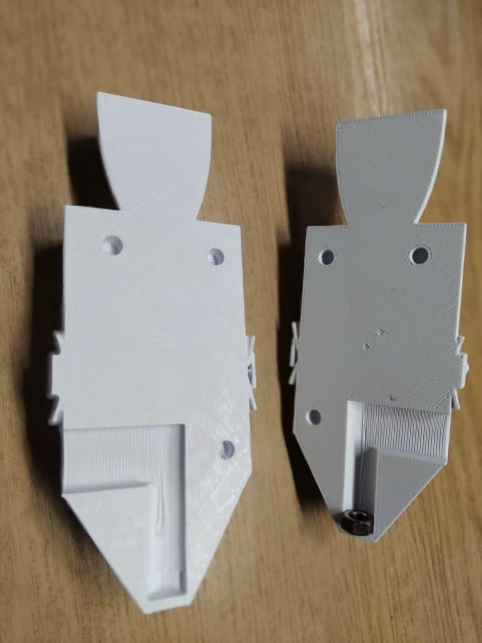

The command module was modified (in Fusion 360) to make space for the docking sensor assembly mounted inside. Additionally, a bracket was designed and printed to mount it to the base and hide the required wires. The pieces making up the model were printed and assembled using superglue.
Step 8: Docking Mechanism and Sensor
A magnet and a nut pair is used to ensure a satisfying completion event to the docking run. The magnet should only be strong enough to hold the ships together if supported by the strings, which should be able to pull them apart again without human intervention. Some extra printed material is placed between them to ensure this.
Additionally, I mounted a hall sensor (this one) in the fixed ship to detect the moment the two ships come in contact. This ensures that inaccurate calibration and slippage on the pulleys do not cause the position of the base ship to drift if an open-loop software check is used.
The simulation and steppers are frozen the moment the hall sensor detects a dock. The velocity of the ship is checked using the velocity state in the physics model. If the approach or sideways velocity is less than some reasonable threshold (5 mm/s), the docking is judged a success and a win message with stats is printed to the serial port.
Note that the hall effect sensor is a digital device with an open-drain output. An internal pull-up resistor is used when connected to the Uno.
