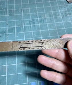

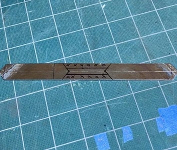

I marked the center of the piece, lengthwise (pic 3-4), followed by the tips that need to be shaped (pic 5), and lastly the cut-offs to make the handle (pics 6-7).
To remove the tips, I used the angle grinder to cut the majority of the excess off, followed by the flap wheel, and then I finished smoothing with various files.

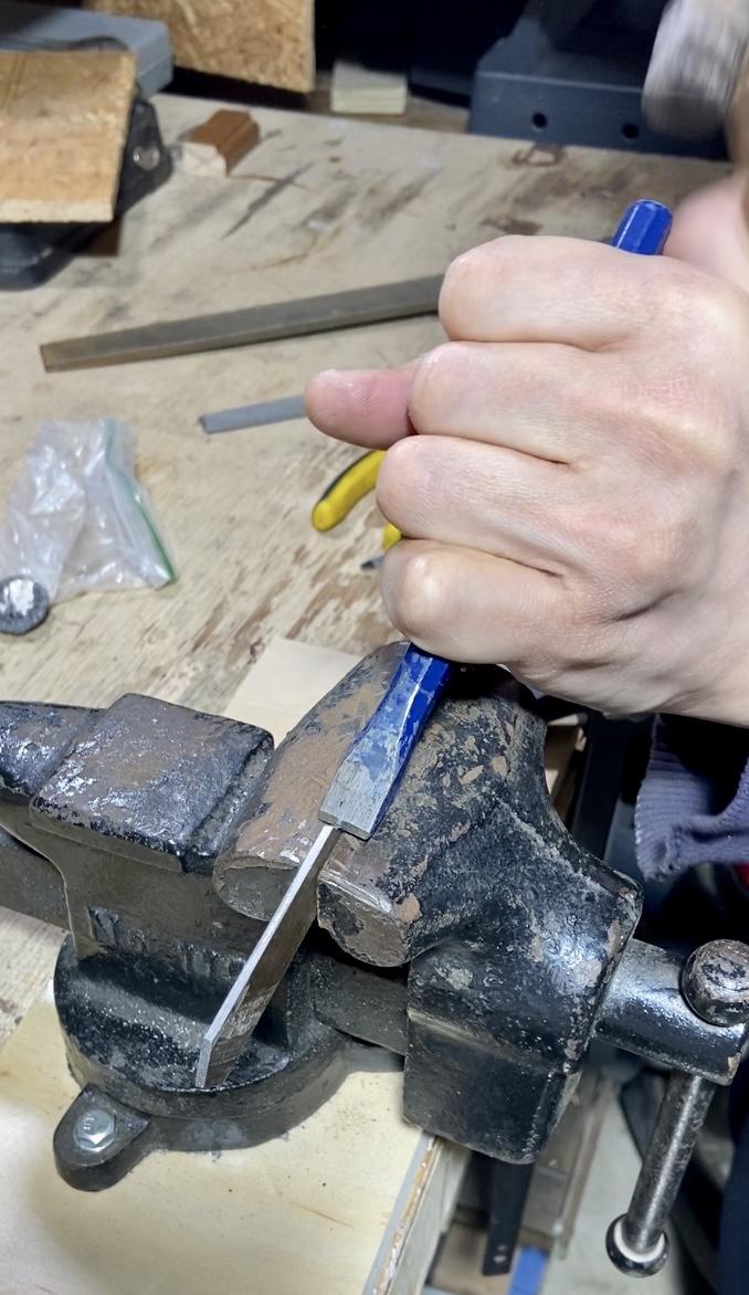

However, when dealing with the handle portion, I approached the "fingers" left over from the angle grinder on the center handle with a cold chisel. I didn't want my novice hands to remove too much metal or make it too lopsided should I have gone rogue with the grinder / files (pic 8-9).
This made quicker work than I expected and put my mind at ease when removing the excess metal.

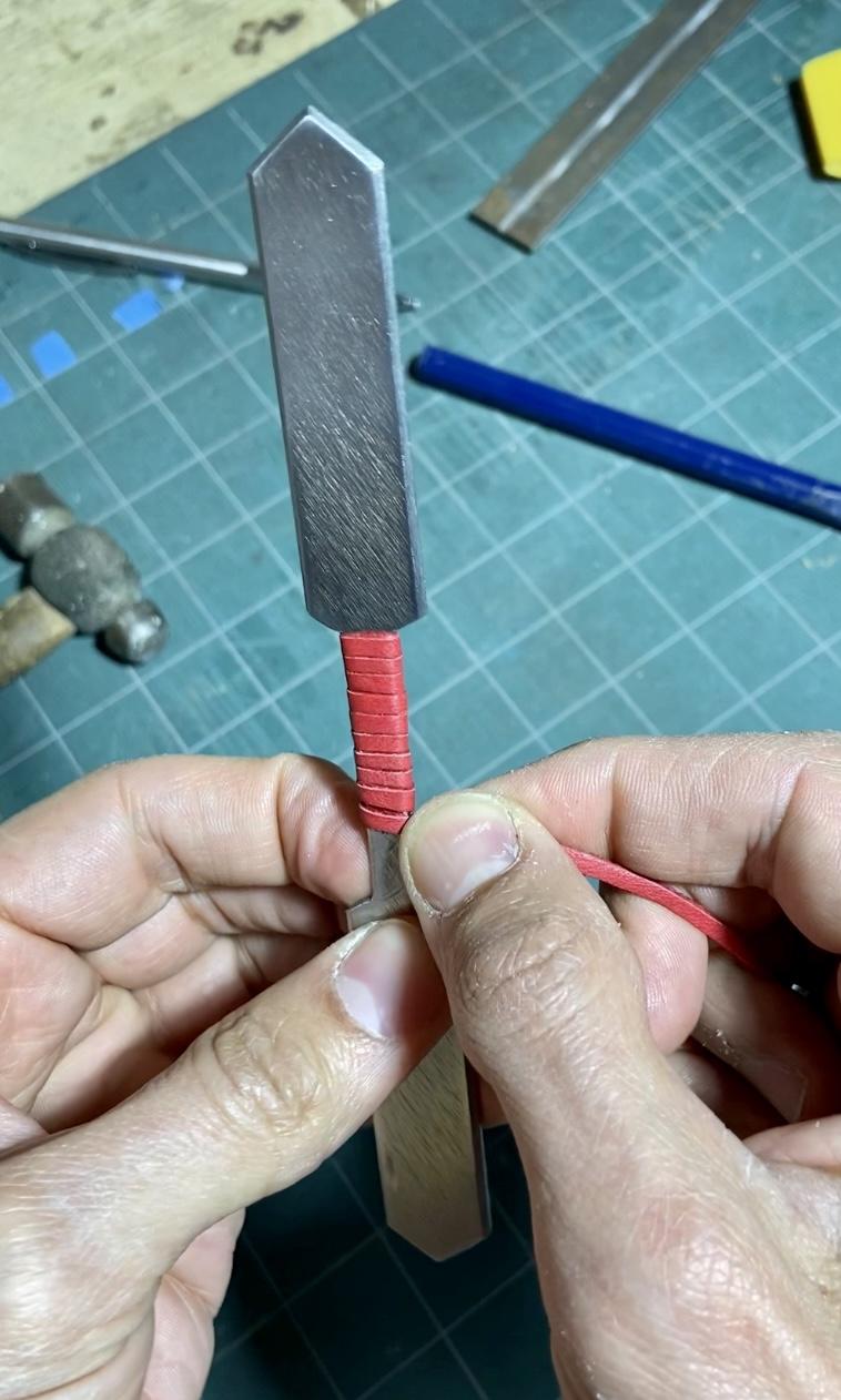

Step 5: Wrap the Handle

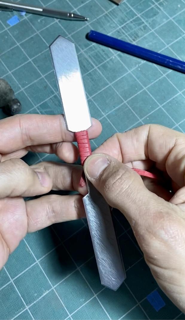

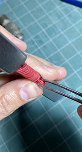

With the blades done, I proceeded to wrap the handle. I purchased some red leather lace from the craft store and got to wrapping.
I started by laying some excess parallel (lengthwise) to the handle and wrapped over it, working my way down the handle (pic 1-2).
To finish, I had a lot off excess lace wrapped over a drill bit (pic 3). While still loose, I put the tip underneath (pic 4), pulling taught (pic 5-6).
I cut off the tail after making sure the wrap was smooth and tight (pic 7-8).

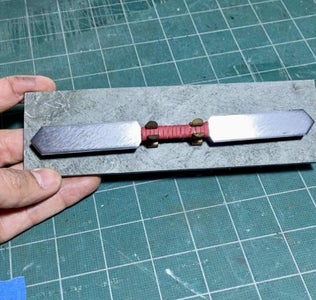

I cut a piece of stone tile to shape to act as my display back (pic 1).
I drilled two holes with a tile bit and kept it cool with water. I would simply dip the bit tip in a cup of water which also helped remove excess buildup.
I will use two brass mounts that I acquired from an old timey stereo. This worked out really well for it's size, however, to get them to screw into the tile, I had to force some scrap wood into the holes. I drilled a tiny 1/16th-inch hole to start the screws and the wood gave them something to "bite" into. Hopefully that all makes sense.
The Butterfly Sword was now ready to mount and display on my peg board along with my other geeky goodies!
