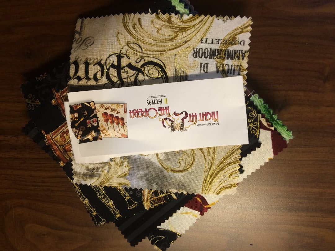

1- charm pack 42-5" squares , they come in a variety of sizes and counts,, the 42-5" has no leftovers
this pack is named Evening At The Opera

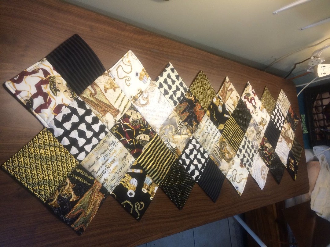

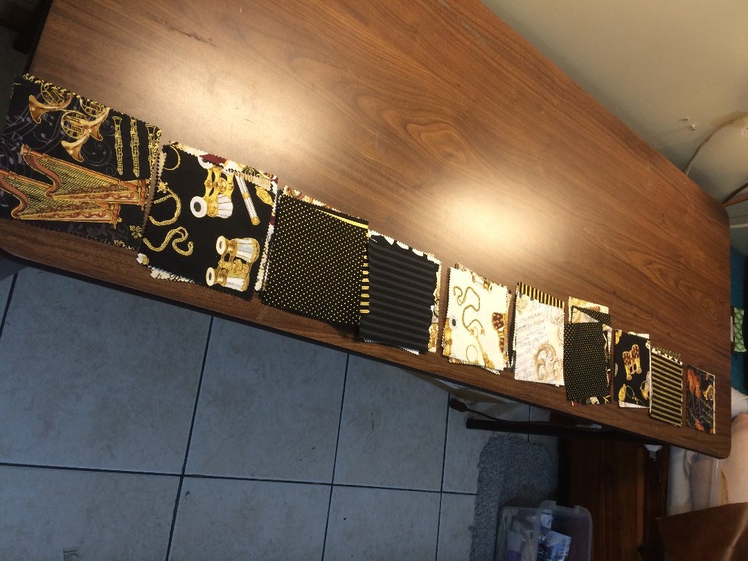

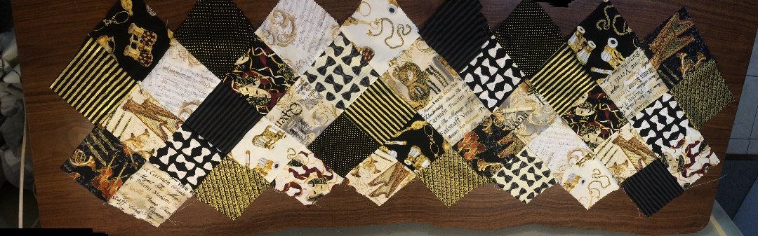

When you open the pack you will have 3-4 pieces of each basic color, start by laying them all out in no special order just yet. The fun part is next.
we will be working with the squares turned side ways with the points on top and bottom,
the pattern is like this, 2 in the first column 3 in the second column 2 in the third 3 in the 4th and so on until you come to the end which will be 2, (see pic) you will see the zig zag shape taking place now.
you can add or take away columns to make it shorter or longer just make sure they are sets of 2 and 3 for uniformity and adjust batting and backing length.
Once you have them layed out you can try to arrange them into some sort of a color scheme, All I can say is good luck! you can arrange them for hours and not be totally satisfied with the evenness of the colors,
Try walking away or squinting your eyes, give your eyes a rest and come back, Just don't be too Anal about it, you will go crazy and never even get started. Just don't put exact pieces or pattern directly side by side, sometimes turning a square 1/2 a turn to move a bright corner around fixes a problem..
NOW TAKE A PICTURE and have it on your camera, phone or computer for reference, this is important later on when you get started piecing it all together

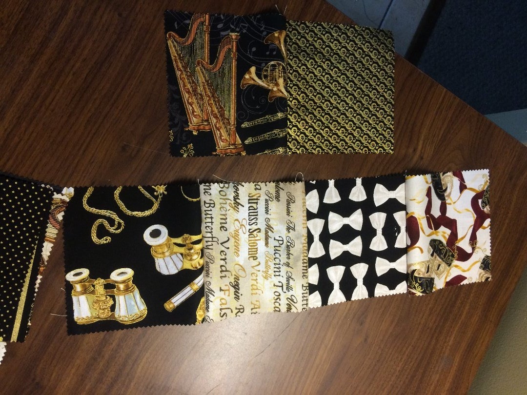

I prefer to chain stich whenever possible, it saves time and thread, chain stitching is basically sewing several parts of a project at one time without lifting the needle then putting the smaller parts together to make bigger parts and so on.
First off stack your squares in order into 9 piles 2,4,5,5,5,5,5,4,2 as pictured,
next using a 1/4 inch seam allowance, set on 2.5 stitch length and following your reference picture sew your columns together one square at a time or chain stitch in sets of 2 then the 2s into 4s then add the fifth square on the end of the 4 square strip, be sure to not lose the orientation of the squares, there is no need for backstitching or lock stitching since all seams will be covered by another seam sooner or later, Do this with all 9 piles to make your initial 9 strips

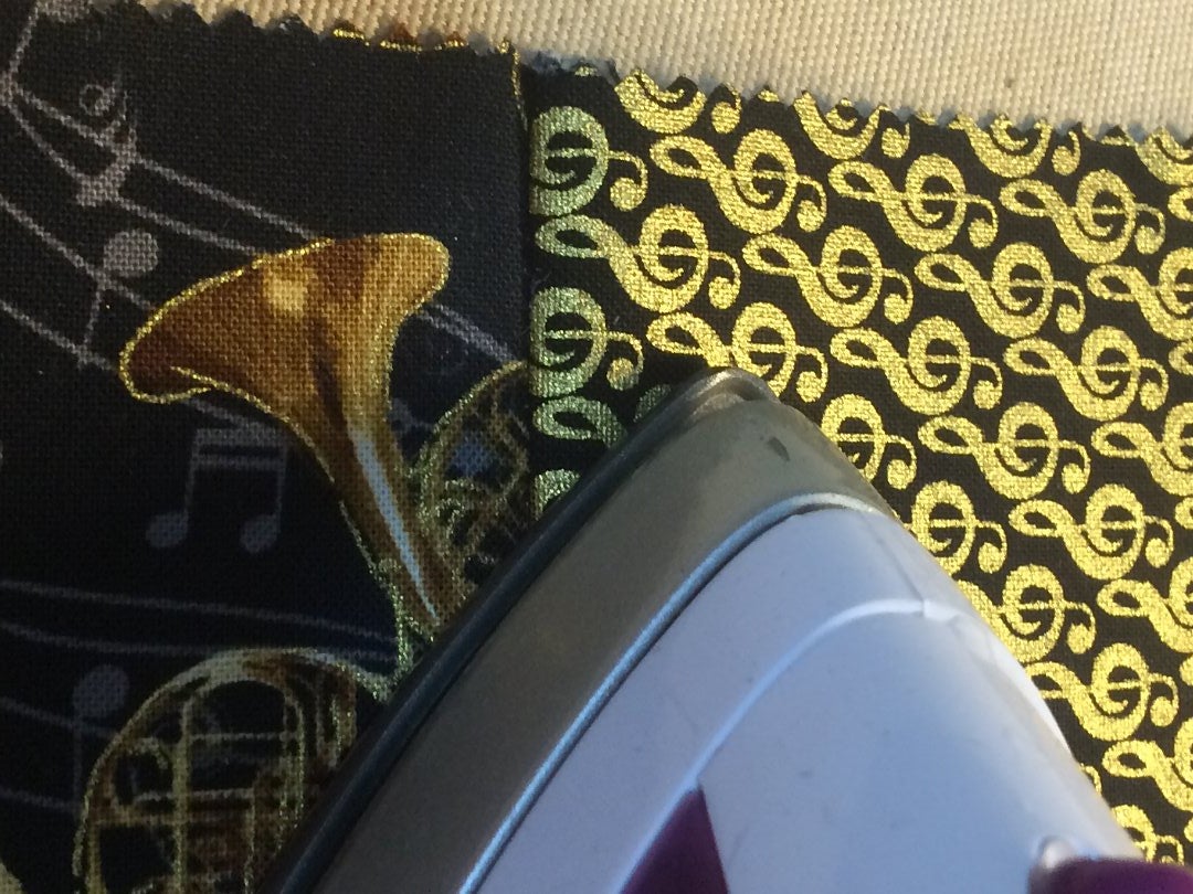

LOTS OF STEAM
Ironing is an important part of quilting,
There are several steps to follow to make sure everything lays flat and your points line up perfectly
I imagine there are countless techniques but this is the way that works best for me.
pressing your seams in opposite directions on each column will give you a flat seam when you attach them together, and they will butt up against each other when sewing, then on the top side you will have exact points, as long as you keep your 1/4 inch seam allowance at all times here's how it works.
My first strip I fold the seam upward and press it then the second strip I iron the seams downward then the next upward and so on until I get to the end.
I like to use wonder clips instead of pins when possible to save time and my failing eyes don't have to work so hard trying to put pins in exact positions.
Setting the seam, I don't know the science behind it but the pro's do it so this novice does it too, I think it gets the material hot and steamy to help getting a sharp crease, with the piece flat press on the stitch line firmly, don't wiggle just press down, then open your piece and press the fold to the desired direction, Remember 1 column up next down and so on,

I have made a picture for the layout of this and you should have your reference picture available,
Your first strip that has 2-squares attaches to the 2 middle squares of the second strip with 4 squares
Next the second strip with the 4 squares attaches even with the top of the third strip with the 5 squares
Then the rest of the strips are attached to the second square down on the next one, all the way across until all strips are connected.
I hope that wasn't too confusing, just follow the picture

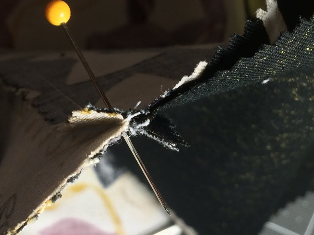

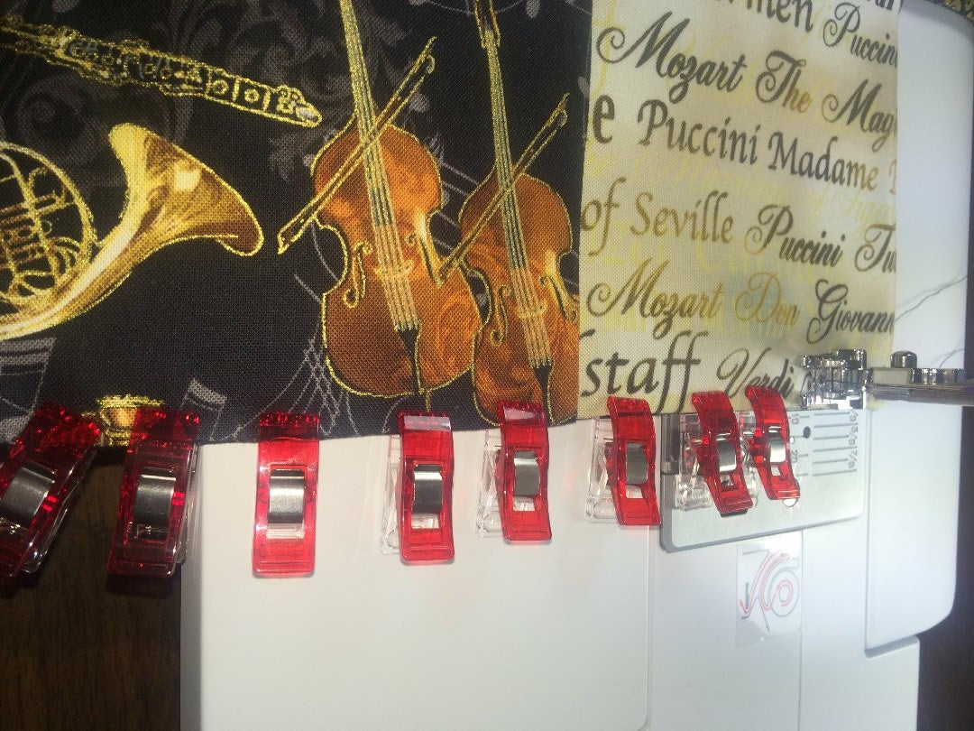

PINNING and USING CLIPS

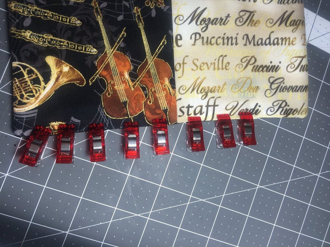

As I said earlier I like using wonder clips, I got a bucket of them on ebay for dirt cheap, they make closing bag edges easy and for projects like this its a real time saver, I show how to use a pin for this but I use a clip.

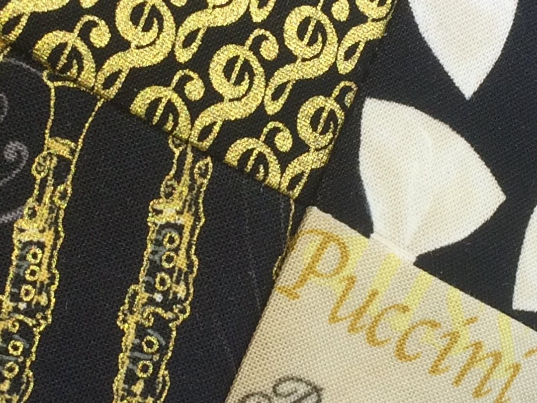

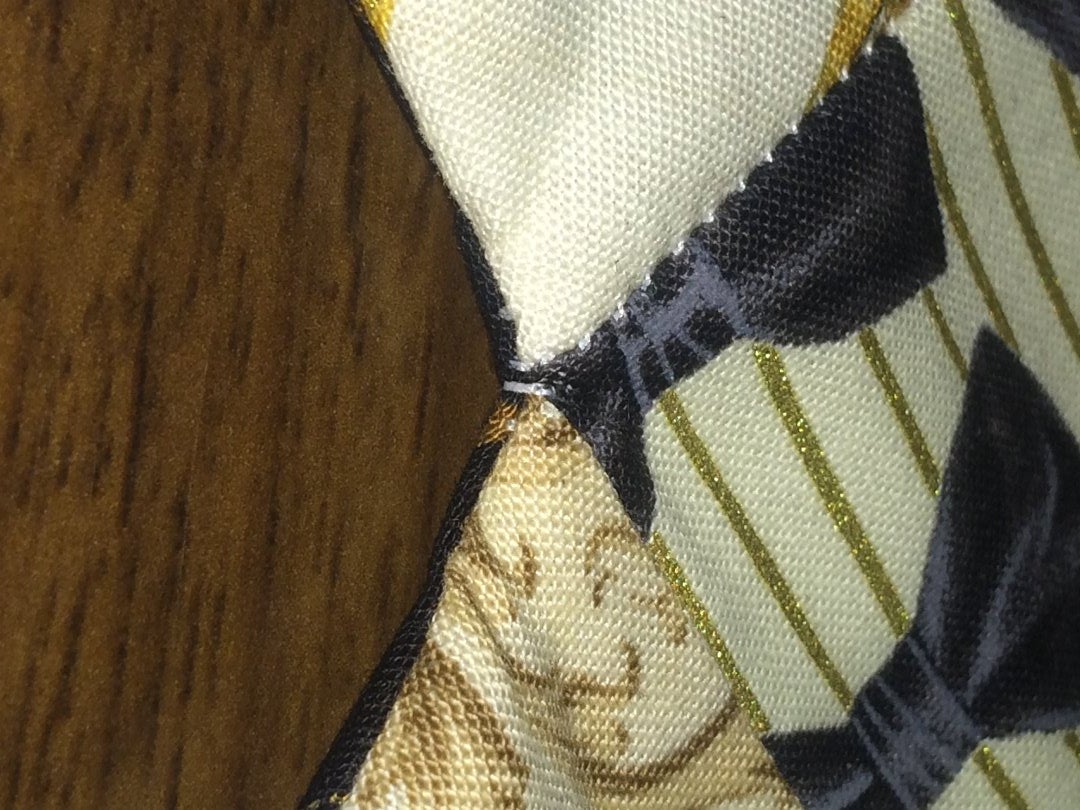

heres how I get sharp points,
make sure to keep your strips positioned correctly and only do one strip at a time to avoid a date with the old seam ripper.
Lay your 4 square strip over onto the 2 square strip face down into the correct position, Butt the folds going in opposite directions tightly into each other, (see pic 1), picture 2 shows the connection with a pin and picture 3 shows with a clip
I like to use the clips on every joint all the way to the end to ensure the joints stay tight and my edges stay flush,
no backstitch or lockstitch is needed here either, when you get to the end of the line just stop or sew off the edge as I have done here,
Do this for all 9 strips remembering to check strip alignment and orientation before sewing them together.
now is a good time to snip off all of those pesky little tag ends so they don't show up on the front of your runner.
Step 6: Top Side Final Ironing
Once you are at this point, all that is left is pressing all of the seams flat,
Do as you did in the first pressing of the strips, setting the seams and pressing your folds in one direction, at this point it don't matter which way the folds go, just start with one of the 2 square ends and have at it, you will notice they will lay in a nice uniform layer, I lay it on the table in front of me and pull it over the ironing board and let it drape down to the floor as I go, your joints should lay like those in the last picture.

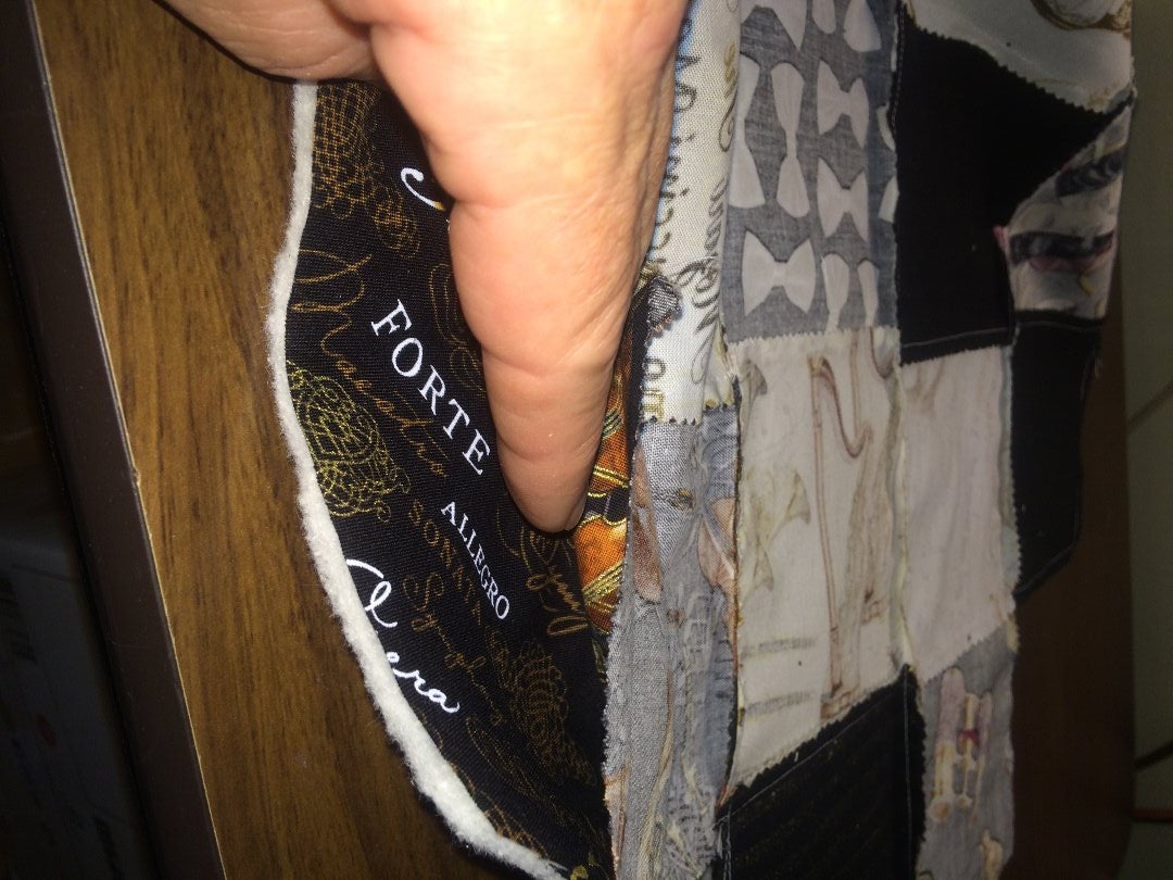

Now reach into the opening you left at one end between the backing and the top,and grab one point at the other end, slowly and carefully pull the whole thing through a little at a time, turning it right side out.
Right about now its fairly ugly, but don't worry about the shape just yet,
With your fingertip first, start pushing all of the points out into place, it will start taking shape now somewhat.
Then with your pointed object of choice, I use a cooking chopstick, work each point to a sharp point by wiggling and twisting or picking with a pin or however you see fit. Just get them all to your liking,
The inside corners are another challenge, they look misshapen and deformed, but there is a way to fix this if you cut into those V,s far enough and your 1/4 inch seam line stayed true, Here's how.
Grasp 2 points and firmly pull them away from each other, this will get them started to lay down, roll the v between your fingers a bit and repeat pulling one point at a time until you are satisfied, it will take some maneuvering but this will work if you keep at it. Look on the back side as well, some wrinkles appear here at times, The next step is ironing it flat for quilting and topstitching, some imperfections can be corrected then too.

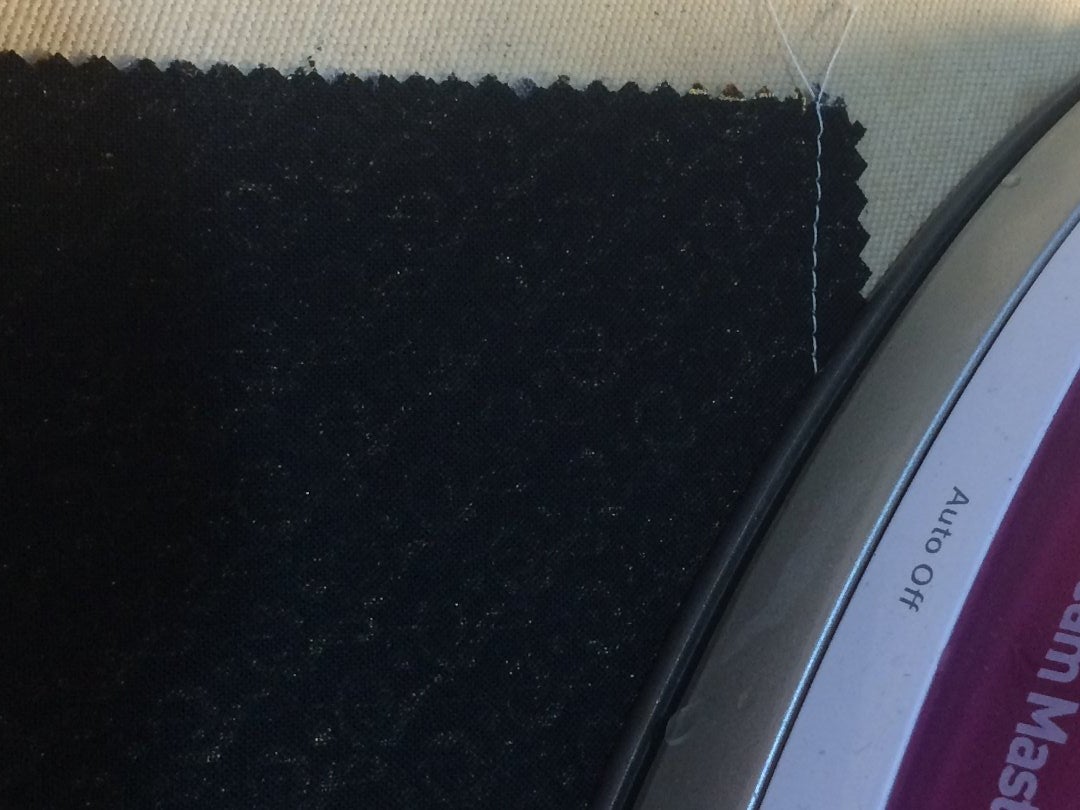

Ok. so you are happy with the results of turning this runner the right side out. Time to iron it flat so we can topstitch the edges and quilt it.
Starting on the opposite end of the opening, go ahead and iron out all the wrinkles and any areas that need attention, along the edges make sure the bottom isn't rolled into top view or the top rolled over onto the bottom.
Make sure that you don't iron any creases into the backing at this point,
When you come to the opening where you turned it at, fold the top 1/4 inch into place inside and press it so you have a crisp straight line, this will also heat the batting and backing layer enough so that you can fold it inside to match the top. Once you are satisfied with the positioning, go ahead and steam it into submission then pin or clip it into place. you will sew here first.

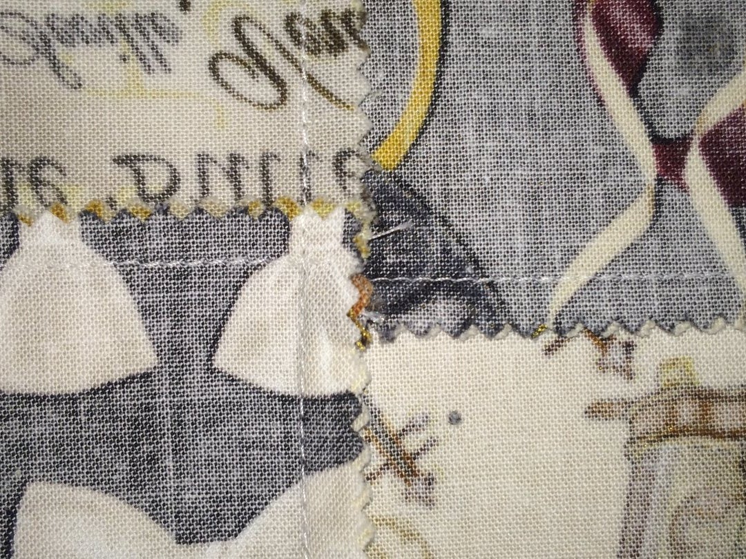

**NOTE** this quilting style leaves the edge connections with the topstitching seam line a little messy, See picture. those inside corners don't line up evenly with the ditch, I make the jump across that little gap as close as possible and don't fret over it too much, Its a table runner not an evening gown.
The other option is to sew each row individually which certainly cleaner, I just do it this way,
