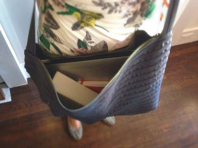

The favorite bag I've owned was a zipper messenger bag made by Zip It. I've had it for many many years and it's finally starting to get a little tired, so I thought why not make one myself?
This design is definitely inspired by the Zip It look, but is not made to unravel in a continuous way... aside from the cool factor when you first get the fully unravelable bag, I found that I never ever unraveled it once. By sewing in the straps onto the bag, it actually makes it stronger and more balanced in my opinion.
Zipper bags are super fun, cute, strong and you can adjust the dimensions as you wish. Hope you have fun with this one!

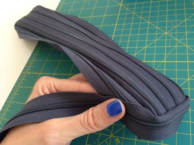

Step 6: Make the Strap
Because of the size of this bag, I decided to make a strap of 2 zippers to make it stronger, but you can definitely get by with a single zipper.
- Measure and cut 2 zippers. Mine were 48" long.
- Pin then together wit the same style of overlap as the back.
- Sew them.

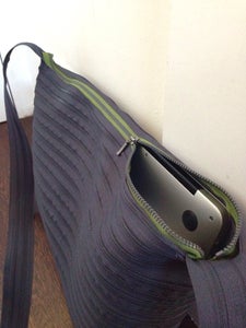

Step 9: Sew Once Side of the Color Zipper
- Flip the bag right side out.
- Pin one side of the color zipper onto the edge of the bag.
- Sew.

Step 11: Sew the Other Side of the Zipper
- Pin and sew the other side of the color zipper, being careful that it will align nicely when closed.

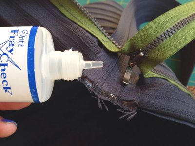

Your bag is pretty much done, but we want to make sure the cut zippers won't fray.
Apply a healthy dose of the liquid seam sealant on each cut zipper ends inside the bag.

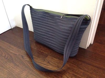

Step 13: You Have a Bag! It's Made of Zippers!
Congratulations! Now go show it off!
