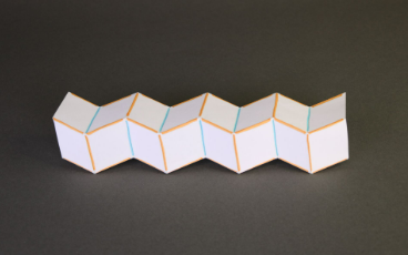

Step 1: Print/Laser Cut the Pattern
If printing:
The pattern will not be as precise as if you laser cut, but it is easier to have access to a printer. You can print the attached PDF file below with the pattern.
If laser cutting:
The pattern will be more precise. Use the attached DXF file to laser cut the precise pattern.

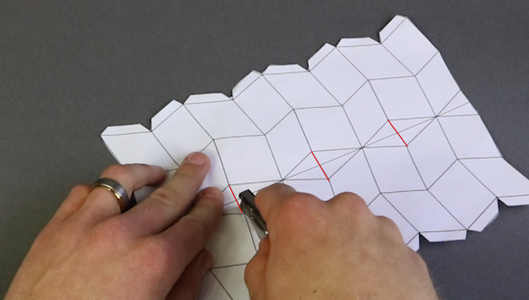

Step 3: Make Folds
On each line, make the corresponding fold:
On Orange Lines: Make mountain folds.
On Blue Lines: Make valley folds.
Cut along three vertical, uncolored lines in the middle of the pattern with an X-acto blade.

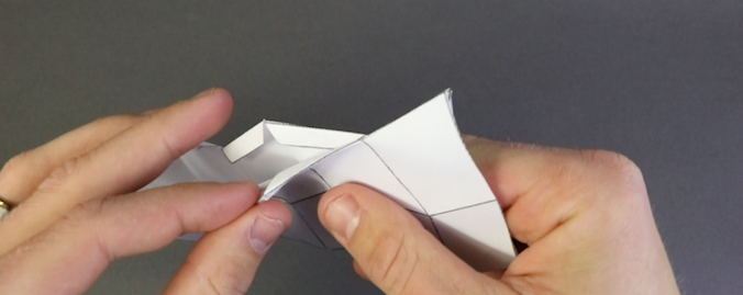

Step 4: Crease and Glue Middle Line
Along the horizontal line across the middle of the pattern, make a valley fold. In the triangular boxes on either side of the middle line, fold the boxes in on each other and glue them together.
(This step can be a little confusing, so you can reference the video from 3:41-4:24 to see how to do it).
Step 5: Glue Top and Bottom Tabs Together
Fold the tabs on both sides of the pattern inwards so that they are facing each other like so. Glue the tabs together. This will make the tube almost two-dimensional.
Step 6: Re-crease Folds
When the tabs are glued together, the pattern will be flattened out, so the folds will need to be re-creased.

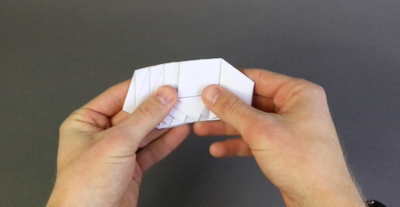

Step 7: Compress Tube Into Small Volume
After the folds have been re-creased, the zipper-coupled tube will hold a three-dimensional shape. Then, the tube can be compressed into a small volume as shown.
