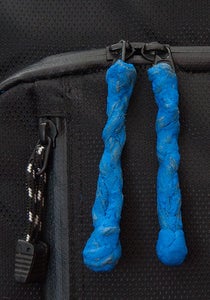

After two years of moderate/heavy use my camera bag had lost some of it's zipper pulls, so I set out to make some replacements.

Step 7: Sugru
As nice as the natural look of the jute is, I have my doubts about the long term durability, and it doesn't blend very well with the bag. I finished my zipper pulls with Sugru, an air-dry silicone rubber material. It comes in a variety of colors, the black blends quite well with the bag.
Note: Follow the directions on your Sugru packet to get the best results, and though sugru is classified as not-hazardous, they recommend that customers with sensitive skin wear gloves while working with the uncured product.
Step 8: Applying the Sugru
Here you can see what the zipper pull looks like before and after the Sugru was applied. The application process itself is fairly simple.  Start by opening the sachet (British for packet?) and kneading the Sugru with your fingers to get it loosened up.  Then work it into the twine as best you can, flexing and turning the pull every which way so as to get the best coverage possible.  You have 30 minutes from when you first open the sachet, to when the Sugru begins to cure, so don't dawdle or open the packet before you're ready for it.  The dry time varies dependent on how thickly you apply the Sugru, but 24 hours was more than long enough in my case. The resulting pull will be quite flexible.  Plus there's the bonus that it will have taken on the properties of Sugru , namely that it will be water and UV resistant.
Step 9: And You're Done!
For the two rather large (nearly 4 inches long each) blue zipper pulls I used about 8 grams of Sugru, or two sachets.  The black ones were a bit smaller, one sachet was sufficient for both.
