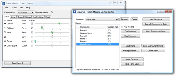

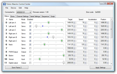

On the control side of things, I used a Maestro microcontroller rather than an Arduino. Rather than using a full on scripting language, you have the capability to control up to 24 servos directly from a GUI interface. It works with keyframes instead of commands, so making fluid movements is very simple! Additionally, you can get under the hood and have it drive its servo pins just like GPIOs, so all the relays for fire control, card control, and whatnot can also be controlled.
There are solutions to both these problems! First, the servos I used are rated to 1600 oz-in (yes, that is 100lb at 1 inch torque) and are sealed to IP66 standards. They cost a pretty penny, but they do a remarkable job. They are from Invenscience...you can find them here. I got the pre-assembled pan/tilt assembly to give my marionette 2 axes of control.
